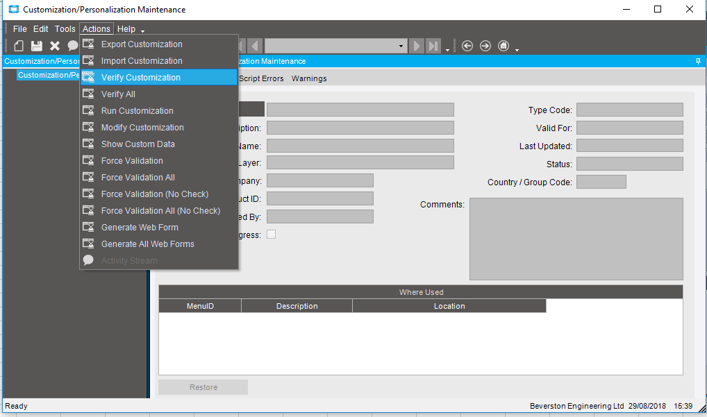

after updating your code on the UI, clear your cache, log off/on, go to the Customization Maintenance BO, and search and select it, then run a verification process.

have you verify your customization as i suggested ?
I just ran that. It doesn’t find any problems, except it doesn’t like the position of my test button.
check the stated properties for your field there?
