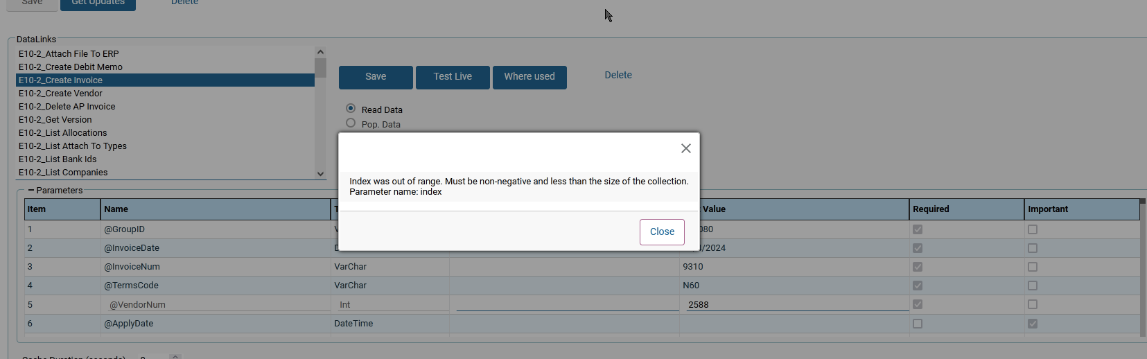

So we updated to 2024.1 this weekend, and it seems like most of the ECM stuff is working, except now I am getting this exception on the integration point “Create Invoice”.

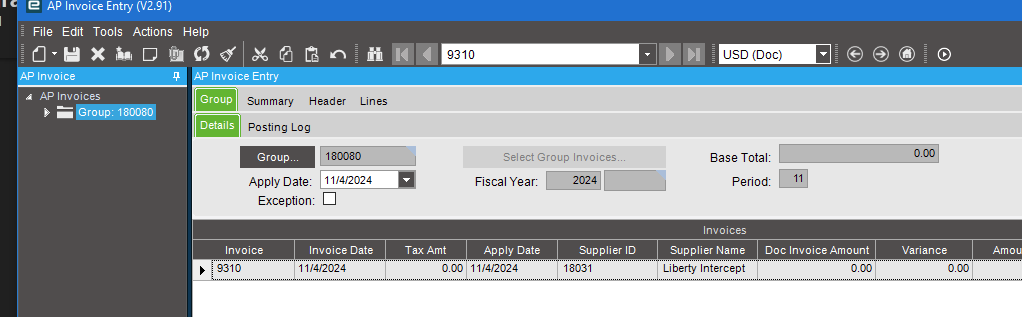

It creates the invoice in Epicor, but it won’t finish the rest of the workflow, which is just attach the document to the invoice.

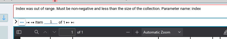

This is the error that it’s sending back, but I can’t figure out what it means. Anyone have any clue where to look for the issue here?
Index was out of range. Must be non-negative and less than the size of the collection.

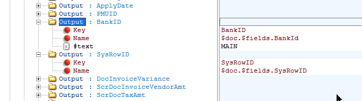

And when it get’s to the attach, it doesn’t have a sysrowID. The Create Invoice isn’t returning the sysrowID for some reason.

The workflow creates it, I see them in epicor. If I just restart, is says “duplicate”… which it is now. So I delete the invoice (it’s not posted), the restart the workflow.
The output literally has no sysrowID coming back, and I don’t understand why.

Brandon, did you ask support to look at the datalink log itself? Like is ECM support helping with any additional logs that could tip you off to something?
I made a ticket, they asked for the recording, and I sent them that. Other than that, I haven’t heard anything from them yet.

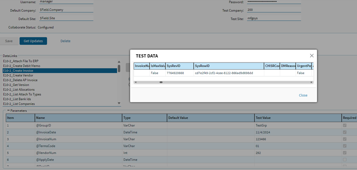

@Banderson So it only take 5 params to make the call work. I’d try it on your end. This screenshot is of my V2 workflow for CreateInvoice showing success and the SysrowID being returned. This is from ECM 24.1.126 to Kinetic 2024.1.14
Let me try
Same issue
It created the invoice though.

If we could figure out the API being called, we could test via swagger page…
Yeah. Although, I am on a different version of ECM. It’s possible the new version didn’t link the return of the sysrowID to the right location. But I can’t really tell that, since their stuff is all hidden.
