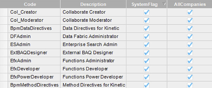

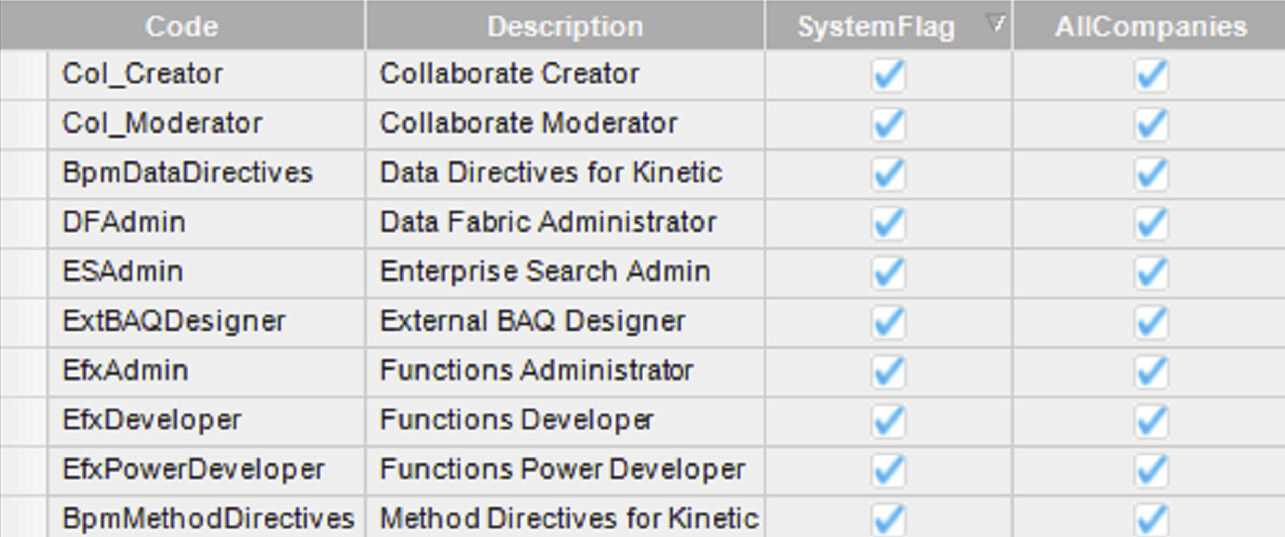

In 24.1 introduces a few new security groups that you will have to remember to add to certain accounts such as manager.

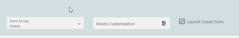

If you are doing a brand new install and you expect classic screens, don’t. A conversion could get ran if the install detects that it is a new install.Conversion 1550 (Erp.Internal.Conversion.KineticMenuMigration Remove classic UI option on new Kinetic UIs). You should be able to uncheck this if it gets checked.
You no longer have more than on options for Classic\Modern Shell\Kinetic. It is just Kinetic (with the actual forms potentially being Classic if you wish).

thanks for heads up - we are still a 90% classic house - so we would have to setup each menu to be in classic going forward?
