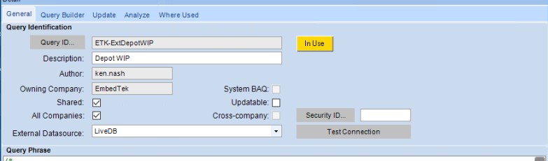

Is the query shared? Is it marked all companies? The other thing to I’d look at is if the external baq has a security ID associated with it
The BAQ looks ok to me.
Test Connection works.

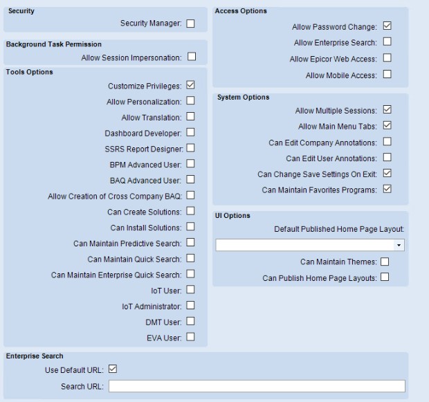

Check user setup
what part? as what should I check in user setup?

I assume you are the owner and in the owning company too? Maybe try switching owners, save, then set back to you

I switched Author to the user and it worked for him and me. I am going to see if I can get the dashboard to pull for others.
I switched Author back to me and the BAQ doesn’t work for user. Its like the BAQ security is set to the level of the author…
