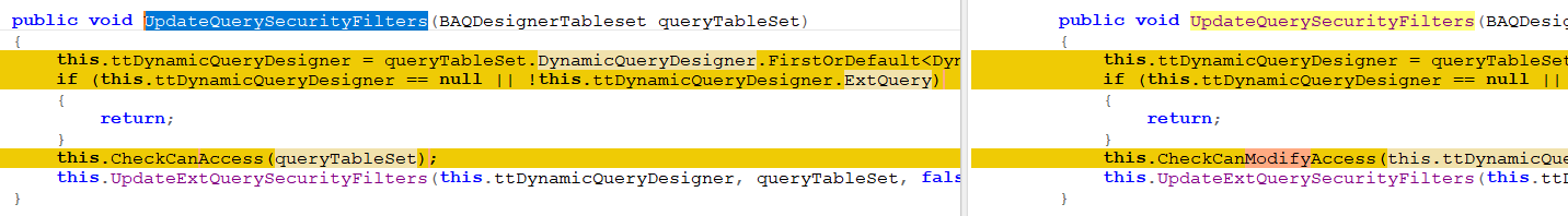

What I narrowed it down with @jgiese.wci (with @josecgomez supervising) is in 10.2.600.0 they had a method called “CanAccess” now its called “CanReadAccess” but it looks like in some places where they had “CanAccess” they are now looking for “CanModifyAccess”.
They all look like they are in good order, however I bet Epicor BO runs some of the other methods such as UpdateQuerySecurityFilters and so on, when merely executing the ExtBAQ and therefore it throws an error when used in a Dashboard etc…
Example the Method in the stack UpdateQuerySecurityFilters only required CanAccess, but NOW it looks for CanModifyAccess, like a few others and it triggers the exception.
The BAQDesigner BO adds also the following new classes:
I wonder if it knows how to distinguish from BAQ vs ExtBAQ. Perhaps the Row Level Security silently breaks during Runtime.
ExtQuery is a bool on the dataset that gets passed through a lot of those methods in the DynamicQueryDesignerRow it’s used in conditions like this
In that case they are calling UpdateQuerySecurityFilters method for BAQ and ExtBAQ, and then that calls the ExtBAQ one… note the CanModifyAccess addition, that should probably be CanReadAccess from what I can read, it just sets security filters on your query… not sure why one would need modify access to mess with tmp :slight_smile: this method may be the culprit hm (CanModifyAccess checks for Author)
