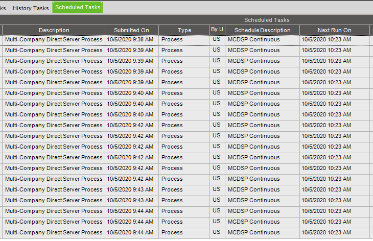

Anyone have issues with Multi-Company Continuous Processing in 10.2.600? Our has a Next Run but it never runs. @JeffLeBert did Continuous Processing break?
It’s just stuck in Next Run, manually kick off works fine.
Sorry, I don’t know of any changes we made in that area that would cause an issue like that.

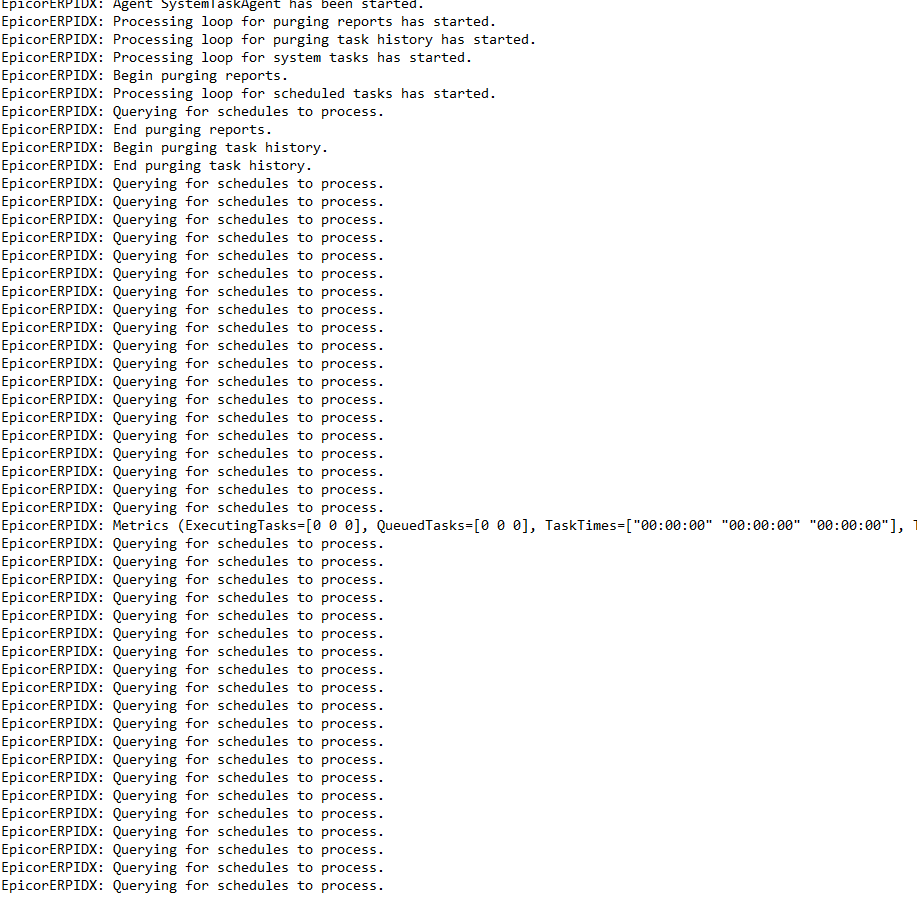

I figured I ask, since I know you guys made some changes to TA. No errors in any logs, it even updates the Next Run On… but it never runs, logging TA, App Server, IIS, Windows (all looks good)… I figured since not many folks are running Continuous perhaps they didn’t see the issue… I hope its not a issue… because Continuous is currently the only way we can run… (Data issues).
Verbose SeriLog
Somehow the query must be wrong… its skipping my task… never finding it.
I figured it out… So a Restart no longer will run the Startup tasks, maybe it never did before either. If you have multiple TA all must be stopped and then you start atleast 1 and Startup tasks are ran. I did stop 1 of them, but it didnt kick off until all of the TAs were stopped.
If you have Startup’s you must do a Stop of all TAs.
If you have a single TA then a Stop/Start worked while a Restart didn’t trigger them. FYI

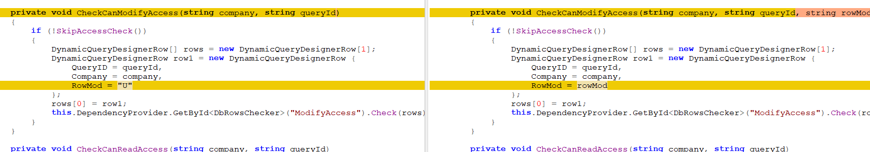

Interestingly enough, I don’t see any reference to ERPS-145562 in the release notes of 10.2.600.13 which is supposed to be the fix for the external BAQs. Shouldn’t a code fix like this be noted in the release notes?
I didn’t see it noted in the Change List but comparing .10 to .13 I do see the fix applied. @kfierce @JeffLeBert
Thanks @hkeric.wci for checking. Do you know who would be the best person at Epicor to have a discussion on why changes like this and others are not documented in the release notes.
It sure makes it more of a guessing game when we apply and test a patch when we don’t know what what changed.
Just checking… have you actually confirmed the fix works in your environment? I’ve been keeping an eye on this thread as it would be a major show-stopper for us if I pushed to a version with the problem.
The code dun lie. It’s fixed.
I too have been following this thread for the same reason. I’ve only done a cursory test, but it did seem to fix the issue for us.
Yes, just tested. Works now in 10.2.600.13
