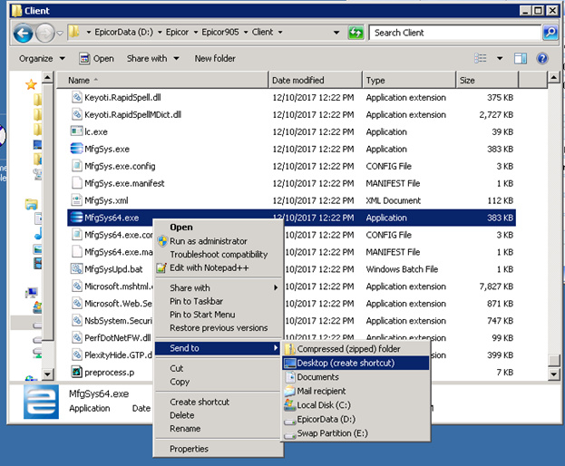

I believe it is just a matter of creating a Shortcut to the MfgSys64.exe Application from the \Epicor905\Client\ folder.
Here is the Warning when using it:
