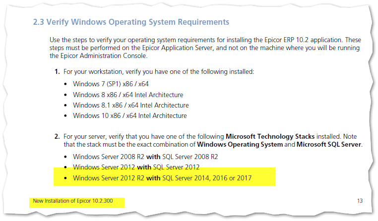

Does anyone know if 10.2.3 will run on Windows Server 2012 R2 and SQL Server 2014? I know the sizing guide suggests Windows Server 2016 and SQL 2016.
From the New Install Guide for 10.2.300
Thanks! Is that Doc available on EpicWeb? I can’t seem to find it.
In the downloads section
https://epicweb.epicor.com/Support/EpicorERP/Downloads/Version%20102300/Epicor10_NewInstallGuide_102300.aspx
Ah, thanks. I apparently don’t have access to that.
