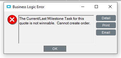

We’ve been getting errors ever since the upgrade. They’re all related to the “servers”.
What kinds of errors? Connection? Client? Screen (Kinetic related)? ???
This was the most common error
That’s related to CRM configuration of the tasks, nothing to do with infrastructure

Please check the CRM Task setup. Most likely Epicor would have added a validation.

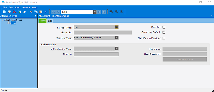

- Attachments have been moved out of company maintenance and now have their own table. This change does not allow users to attach documents without having a document type selected unless you set up an attachment type maintenance like below.

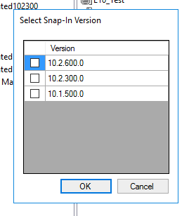

- Copy PRD_102300 SQL Database to TST_102600 SQL
- Register the Database TST_102600 in Admin Console (when you do this it should ask you which snap-in version you want)
- Upgrade TST_102600 via Admin Console (Database Node still)
- Add New AppServer TST_102600 and point it to DB TST_102600 (this will also ask you which snap-in version you want)
- Login and it’ll ask you to run Conversion Workbench, do it
- Setup Task Agent stuff… etc done.
So if you create a new App server for 10.2.600 (with a different App name), then previous posts about having to remove the prior version don’t apply?
It’s only when trying to upgrade an App that was originally created with a prior version?
