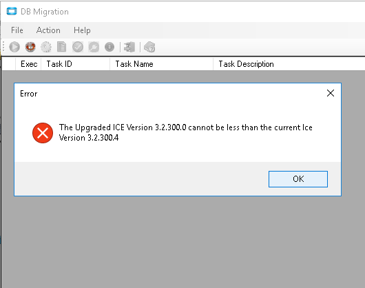

But now, when in Admin Console, I am getting an error when trying to upgrade a database from 10.2.300.4 to 10.2.300.16 which says “Upgraded ICE Version 3.2.300.0 cannot be less than the current Ice Version”. I did already uninstall admin console and task agent, then reinstall them, then apply the update for admin console from the 10.2.300.16 folder but I am still getting this error. I double-checked the timestamp of the filenames for Admin Console and they do match the 10.2.300.16 files, so the update was applied there.
You don’t need to run the database upgrade routine on a patch.
If you log into the client, it should ask you if you want to upgrade it to the latest patch level.
Thanks for the quick reply Aaron. Launching the client did the trick! I don’t know why I thought I had to do it through admin console or why that fails but this works now. Good to know.
