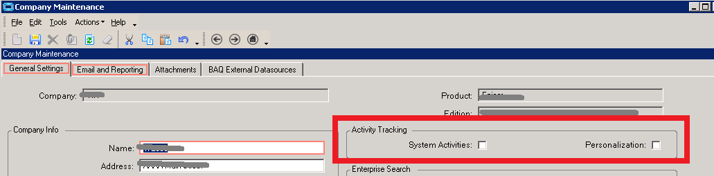

You may need to enable “System Activity Logging” in Company Maintenance first

Where is the System Activity Logging option in Company Maintenance? it looks like I may not have it in DT.
Do I need to enable account lockout policy to make the System Activity Logging option appear? All i’m trying to get to is the User Session Log report which is missing as well.
//edit : Set up a lockout policy in Security Maintenance > Account Lockout Policy, still no choices for System Activity logging in Company maintenance. This is frustrating because I don’t have access to the System Administration application, so I appear to have no way to monitor who is logged in to my instance of DT.
Try Company Maintenance

On DT that area is blank. There is a box for Web Access and that’s it. I guess I will ask support to turn it on for me.

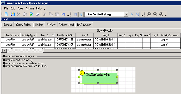

You should also be able to query the table Ice.SysActivityLog to see if system is logging active on your system
