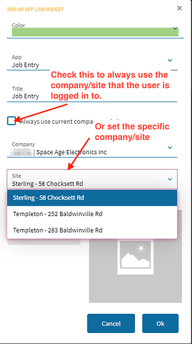

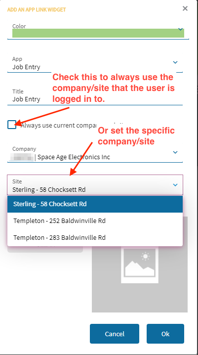

Using the Active Desktop, you can set the company & site that an application should open with on the shortcut.
When you add a program link, the dialog lets you set the option to use the current company/site or specify the company/site to use. So what we do is create a shortcut on the desktop for each application & site combination the user will need and indicate which site it is in the name.
