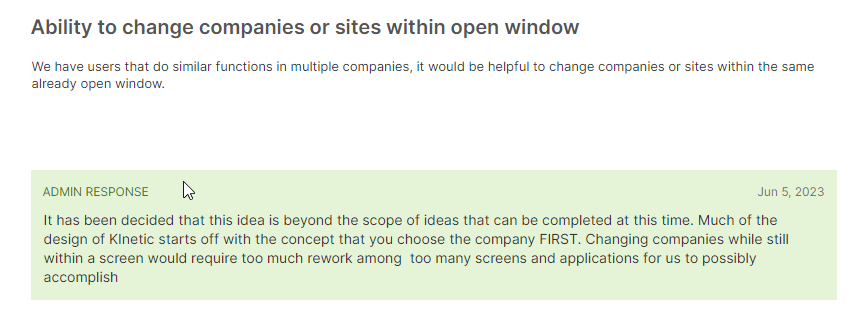

Here is Epicor’s official response on the request , which amounts to, its too hard so we won’t bother trying to address this massive pain point.
Is there an IDEAS we can vote for? Improving this would be a huge benefit to multi-company users who interact in multiple companies and sites.
In the meantime, we’ve created app shortcuts with specific companies (instead of current company). This way you just click once to open the form in the specific site, instead of having to minimize the windows, maximize the homepage, click on the user icon, click on the site/company dropdown, select it, wait, and then open the app in the right company. <----- Epicor - this is a lot of extra steps!
The idea I screenshotted is here:Log In - Epicor Identity
You can vote for it but its already marked not planning to implement so I doubt it will do any good.
