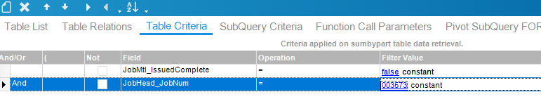

I created a BAQ to provide a pick list by bin number. My BAQ is a little complicated and has 3 subqueries and one top level. I can add table criteria in the top level to restrict to only specified job numbers.

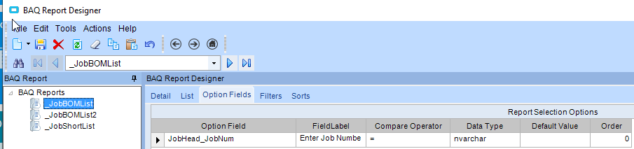

I then created a BAQ Report - ideally, I want to use the filter option to pick the job numbers to print. But when I try to add it - the drop down has JobHead_JobNum three separate times. I don’t know which to use. I tried using each one individually and wasn’t able to get any to work.
I should also add that I removed the criteria from the BAQ when I was attempting to achieve this through the BAQ Report.

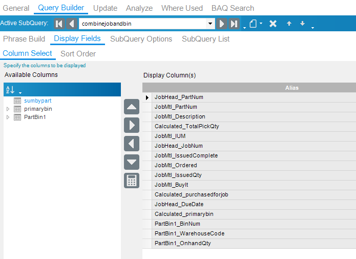

Here are the display fields for the top level
I don’t see anything.
Do you have a subquery? I was expecting to see JobHead_PartNum and Subquery_PartNum
Nevermind, that is displaying correctly.

and finally - the Top Level - called “Combinejobandbin” and this merges sumbypart, primarybin, and PartBin1… and this also has JobHead_JobNum as a display field…

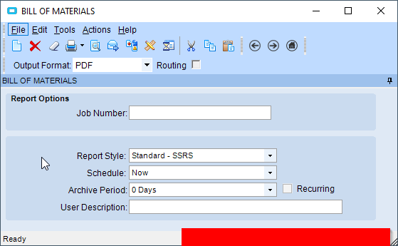

can I add a filter on the SSRS report that asks for user input? I want someone to be able to enter a JobNumber and get the associated pick list
Normally its this simple.
yeah! :rofl: That’s what I was hoping for!!! I can get all that - but when I submit the report I get an error -

I can add criteria and execute in BAQ fine… but I won’t be the one printing daily pick sheets…

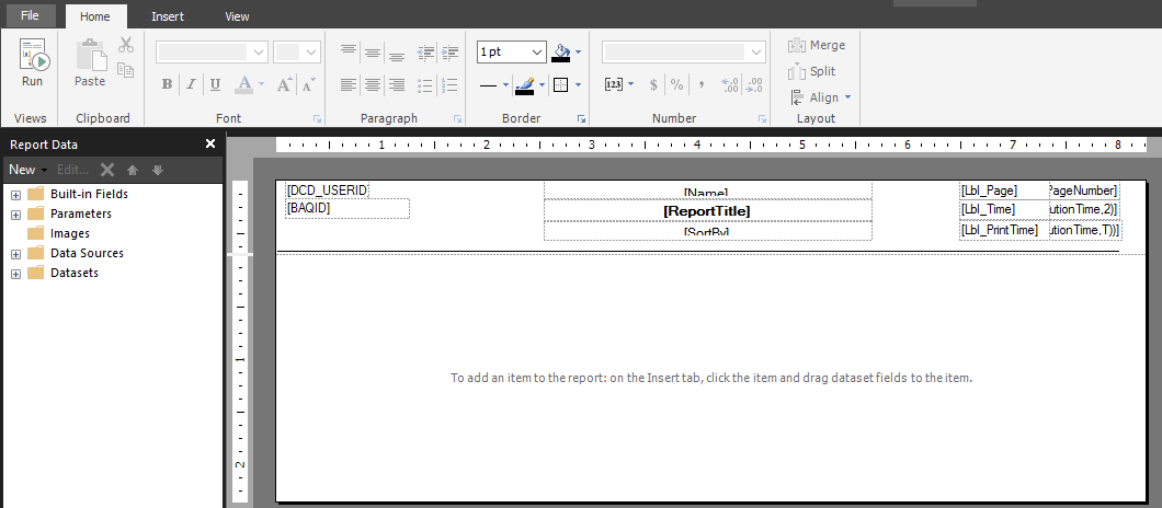

Your error might be caused by a blank SSRS report.
So one thing with the BAQ Report is that you still have to edit the SSRS report in CustomReports folder. It creates a blank template upon saving in BAQ Designer.
Issue I haven’t got around is that every time you change the BAQ you have to create a new BAQ Report Design, which will create a blank SSRS. You can however copy the tables from one sheet to another.
