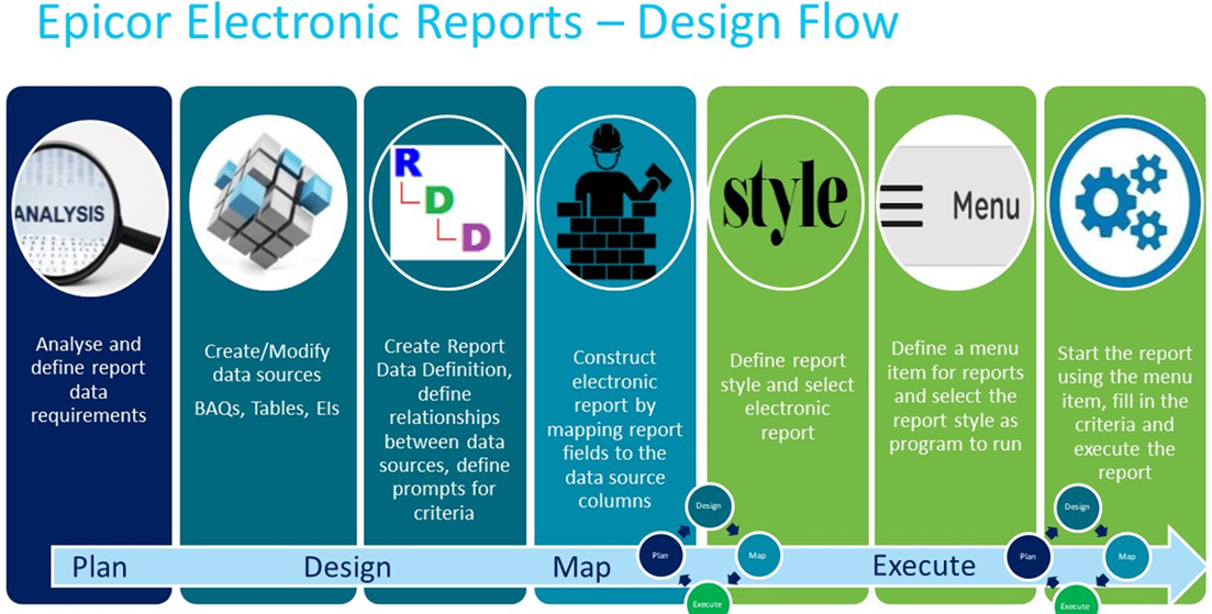

If you build your RDD and then create your style in Report Style Maintenance, you can just do a Action\Create SSRS Report and it will create you the template report just like in BAQ Report. Plus, you get all the data columns are mapped in for you. It should only take a couple more clicks to do RDD + BAQs instead of BAQ Report.

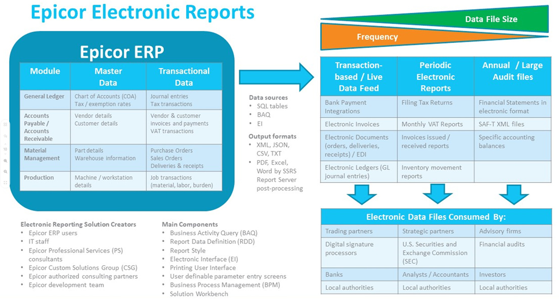

Also in atleast 10.2.500+ Id say 600 I was told you can add multiple BAQs to RDD with Electronic Compliance, Electronic Reports (modules). Not sure if @JeffLeBert can confirm, but I asked that question specifically during a Webinar few weeks ago.
