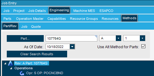

I ran MRP, found the unfirm job in Job Status Maintenance, Firmed it, and then opened it in Job Entry. Then I went to the Engineering tab > Methods > Part/Rev, searched for the same part again, and then dragged the robotic bending op on to the tree view, and deleted the manual bending op.
Is there a better way where the supervisor can just select the alternate method, or does he need to search for the alternate method, then manually delete and add each operation (seems tedious when you’ve got 30 jobs).
