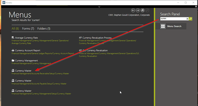

We’d need to see your Payload to help
Looks like you need to set the credit card processing here.

Alright, thanks.
But please how did you arrive at this screen?
I searched for currency and found the screen currency master.
