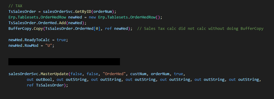

It’s probably the Before image / buffer copy situation. The below code works for me inside a Function that creates orders. Did not have to do the TaxConnectStatus / SetReadyToCalc steps.

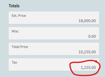

Tax is correct in order detail (I only have one line in this order):

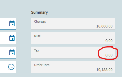

but it is Zero in order header, even though the order total implies it knows about the $1,155 of tax from the order detail:

Might need to see your whole function. In mine I have OrderHed.ReadyToCalc off (false) initially, create all the lines and whatnot, and then set ReadyToCalc to true at the very end in the snippet I shared above.
In my case I’m not updating or adding anything to the order, just calculating the taxes:
(ignore the calls to addToResult(), is just helps me trace/log)
It would be nice if there was a built in extension method that does the whole buffer copy for you in 1 line. I think we all don’t always do it because of the ugliness of dropping in those 3 lines.

However, what I did find by adding in my function that after the master update call, the DocTotalTax value in the returned dataset was set to the correct value, but it is not being reflected on screen after the call (shows $0.00, even after refresh)
This scenario is in Kinetic (web), using an event to call the function
@josecgomez, would you have any thoughts on the latter part of this ?
Very odd… Is the value correct in the database after the fact or is it $0?
What sort of event is calling the Function? I wonder if there are unsaved changes when the function is called and there is a weird timing issue.
Also curious what the business case / problem is here? If UI activity is triggering the Function, couldn’t the UI (App studio) just auto-check the ReadyToCalc checkbox instead of processing all this on the server?
Back at it today, out sick yesterday, so…this is ever so strange
I double-checked, it is coming back correct in the dataset (OrderHed.DocTotalTax) after the call to MasterUpdate().
But using developer tools to trace and look at the OrderHed dataview it is zero.
Also created a query to check datatable and it is also zero.
This makes sense since when I hit refresh, it’s also zero.
I put a slidout in the event right after the function to make sure it wasn’t being set and then cleared by something else, the trace stops right after the function and the slideout and the results are the same.
