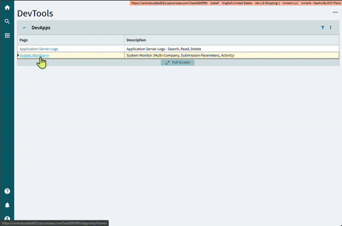

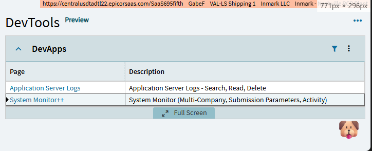

For dev tools, I used javascript to put a doggie icon in the lower right corner of the screen, and create a nifty animation when switching pages within the dashboard. My solution .zip is posted there and you can see the row-update expressions used inside.
Generally speaking, if it says “expression” in app studio, you can use javascript there. If it says “value” it will be interpreted literally instead of passed through Eval(). There are one or two exceptions where you can use javascript without #_ _#
