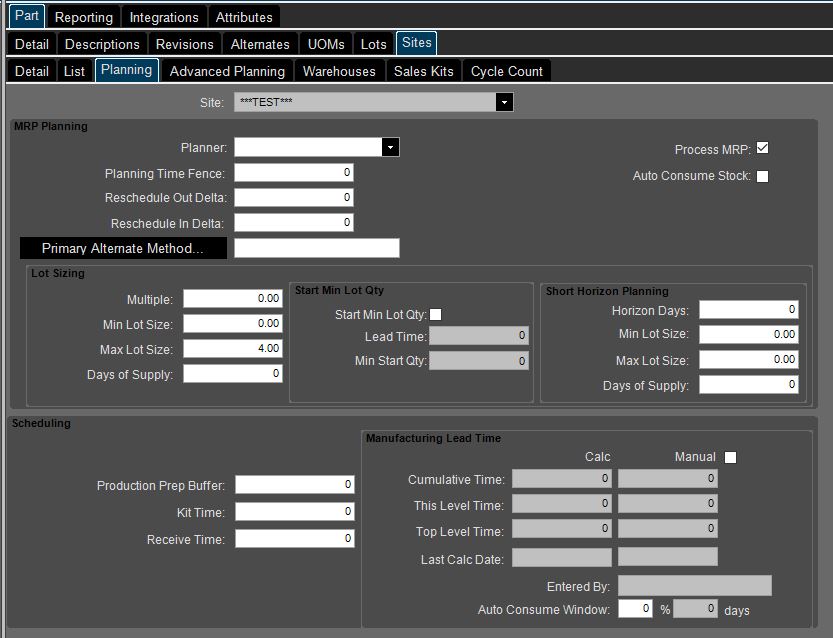

Thanks! I set the Max Lot size to 4 but both Order Job Wizard and Job manager still create a job for 100, any suggestions?

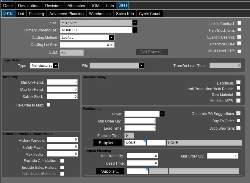

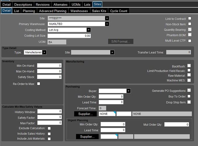

I’m pretty rusty on this. Post a screenshot of your Site tab in part maint so we can see how things are setup.
If it’s something you are planning in the short horizon during testing you might need to fill that out as well on the far right there. Below are my notes from the last time I was doing trial & error testing.

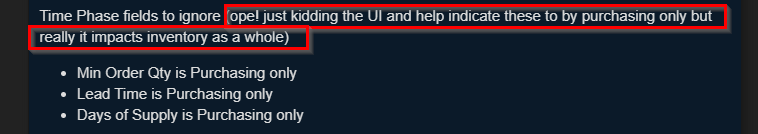

Time Phase fields to ignore (ope! just kidding the UI and help indicate these to by purchasing only but really it impacts inventory as a whole)
- Min Order Qty is Purchasing only
- Lead Time is Purchasing only
- Days of Supply is Purchasing only

You need to set the Multiple to 4 and the Min to 4 also.

They way you have it set now should work. The lot size settings really only apply to MRP, if you create a job manually it can be for any quantity you want.
The min/max/multiple settings all do distinctly different things and understanding how they work and interact with each other is important if you want MRP to size your jobs correctly.

I know I noted that above the fields I had listed as ignore. These are literally whiteboard notes from Confluence so it’s raw processed data as I went through testing.
