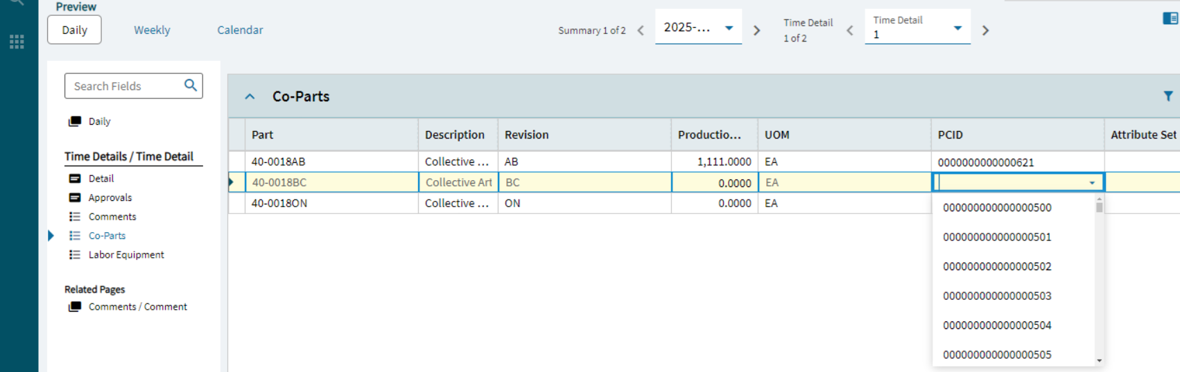

In Kinetic I’ve got the column working with the BAQ and it is showing the PCIDs, however it shows all of the records returned by the BAQ for any Job Number.

The first row already had a PCID in the data - this is showing correctly.
When I use the drop down on any row it shows all PCIDs pulled by the query. No filtering.
