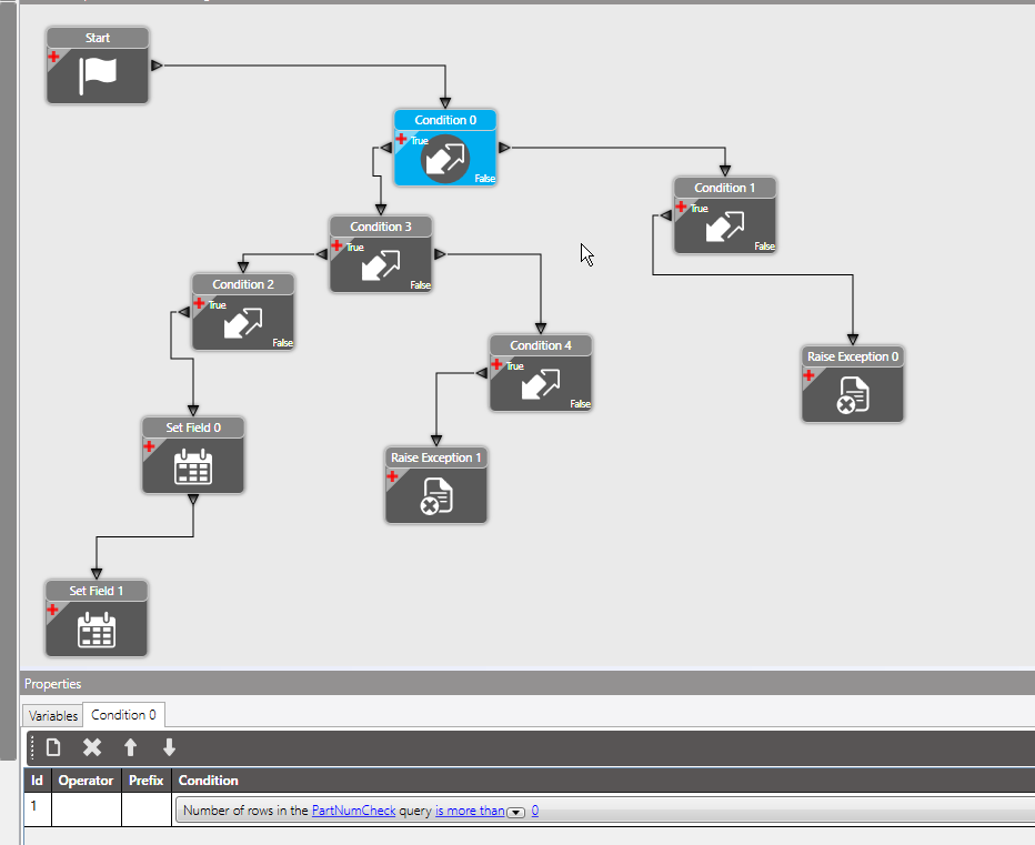

You will want a method directive BPM on on the update method of UD04. This is the easiest way to check on save. This will make it so you can’t mess it up on entry. You don’t need any code to make that work. You just do conditions that run a query to make sure the ID exists.
Then for ease of use you can add the customization as outlined in that thread. That gives you some soft validation, you can make hard validations, but you might piss off users as it becomes a PITA. That’s why I did soft validations with the customization (just warning messages) and then the hard validation on the BPM.

On your advice above, to do a Method DirectiveBPM, would this be pre or post processing?
Pre - you have to stop the method BEFORE it completes.
