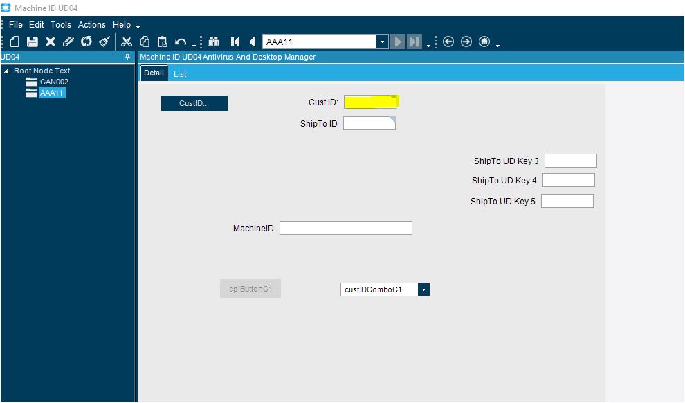

I think I actually want to make sure that the entry in UD04 Key1 is a valid Customer.CustID
My Task:
On the customer Entry Program, Ship To Tab:
Make it possible for users to add :
  • unique machine ID (there can be multiple of these per ship To)
  • Date installed for each machine
  • Grade of Anit virus conver puchased for each machine
  • active / deactivated dates for antivirus cover per machine
I have selected UD04 (we already use 1,2,&3)
UD 04 Key 1 will be the CustomerCustID
UD04 Key 2 will be the ShipTo.ShipToNum
UD04.Character01 will be the MachineID
Before I get to making it work on Customer Entry, I set up UD04 in our menu.
I wanted to be able to add the records there to build up the UD04 Table (in test environment).
And so then I have a place to enter multiple records without opening each customer form up.
At present, Key 1 of UD04 is bound to Customer.CustID, but I could enter anything.
(I have managed to add UD04 to the menu context file xml, and it is available to pull in to a foreign key view).
I would make two buttons Cust ID and Ship To and then use search functions to find each and return to read only text boxes. Validate - check, easy to search - check.
Another option is to use an EpiCombo tied to the customer adapter. Then they can select OR type into it.
Insert an EpiRetrieverCombo
See pages 306 of the ICE manual
Thanks Calvin.
I did this but it came back with a GetAdapter error when I launched the customized form.
I followed the whole workshop on adding Custom Shipping Size container to Customer shipment entry and the combo never displayed any data (I had added the ud table and populated it wih container options).
Confession - I’ve never managed to make an EpiRetreiverCombo work.
But EpiCombo does much the same thing, more simply.
