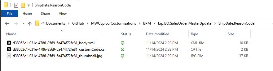

I created a C# program to export the .xml, .cs, and thumbnail that’s in the Ice.BpDirective table, so I can upload that to GitHub and have some kind of change log / versioning behind my BPM changes.
