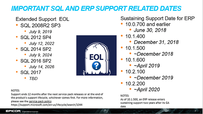

Is there a planned end-of-life for lets say 10.2.100.x? How does one know if they should go to 10.2.200.x (cutting edge) instead. We have hopes that 10.2.100 will keep being patched until it hits 10.2.100.37 or so, is that a valid assumption or could it stop receiving patches as soon as 10.2.100.20 ?

An ERP release will enter a sustained support status two years after it becomes GA, which is not the same as EOL. As of today, Epicor has never (to the best of my knowledge) EOLd a product. This isn’t to say that it won’t happen in the future
<cough>
A number of things happen when a release enters sustained support status, but, the most important in my opinion is that no new updates for that release will be provided after two years. Also, calling into support unless it is a system down also ends when a release enters sustaining support. NOTE: new cases can still be submitted via our epiccare portal for a release that is in a sustaining support status.
A slide from one of my sessions at Insights where I discussed sustaining support dates is below. There are exact dates for when 10.1.600+ releases enter sustaining support, but, the point I was trying to relay wasn’t so much the specific date, but, that it occurs two years after GA.
My advice is to go as current on the release as possible to get as much benefit from the two year period where we will be providing updates for a release. As of today, 10.2.100.x will receive updates for an additional ~18 months where 10.2.200.x will receive updates for an additional ~22 months.
