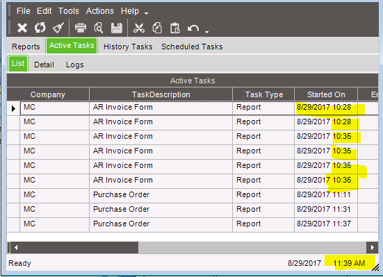

Is there any way to cancel a running task?
As you can see, these have been running for quite some time.

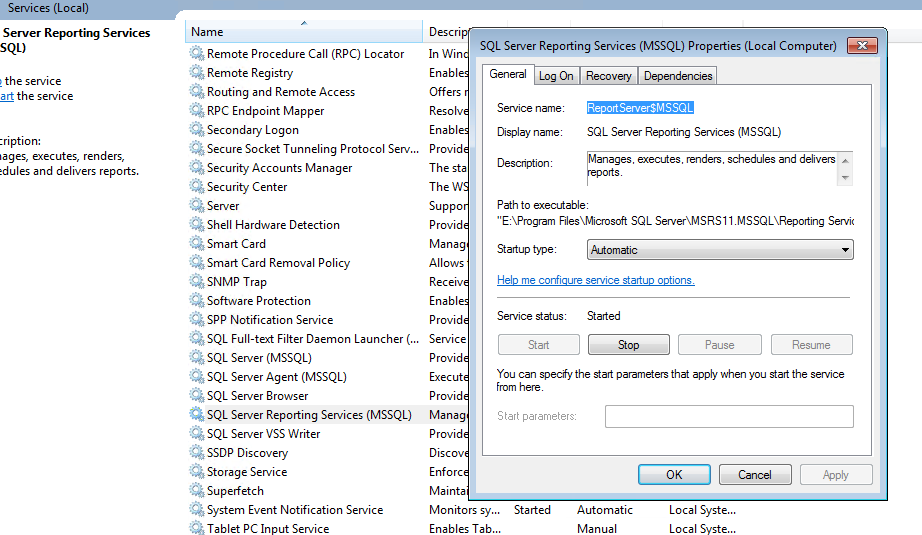

Stop and Resart the Agent, and/or Stop and Restart the Service?
Typically you can highlight the task and click delete which will cancel them. To speed that up you can cancel and then stop and start the agent.

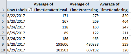

I did the query to inspect the data times on the SQL server, and found that a report run last week which averaged 144(ms?), now takes 198,554(ms?).

Here’s the averages of DataRetrieval, Processing and Rendering times for a report that hasn’t been touched (RDL or RDD).
So yeah … something is awry
