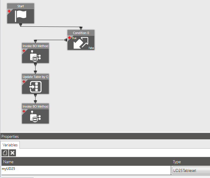

I have a BPM on DynamicQuery.ExecuteQuery which stores data into UD25. I picked up the code from either e10help or the EUG forum.

In case you dont want to store a log and use up a UD table, I made a variation of the post processing ExecuteQuery directive. It just writes a timestamp of “now” to the queryHdr table on a custom UD field. I needed to use the BAQReportDesigner methods to write this date BAQLastExecTime.bpm (31.8 KB)

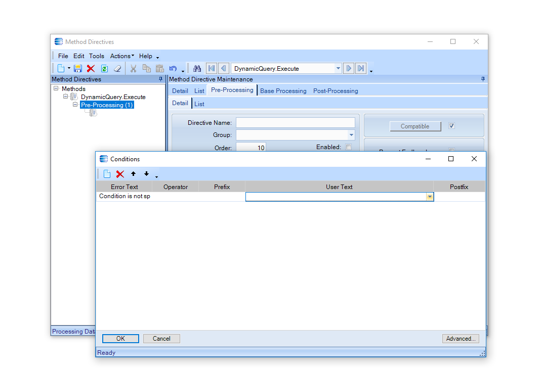

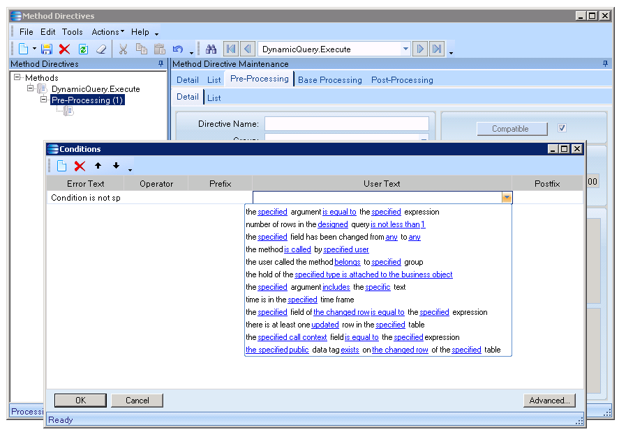

I’ am struggling creating the method code - not 100% sure on the condition & actions to use.
What options are available to you in the dropdown list?
options
So you want the one that says:
numbers of rows in the designed query is
Then you need to click on the “designed” hyperlink, and make it match what I have in the above screenshot.
