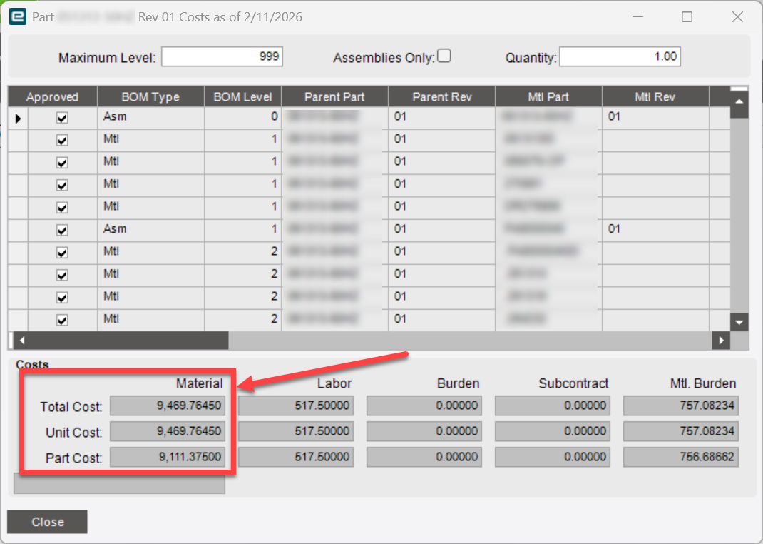

Hello, I am hoping someone can straighten me out. I am expecting these three values on the View Costs to be the same in Costing Workbench. They aren’t. The top two numbers are “correct” but it publishes the bottom number when posting the cost rollup. What’s the difference? What should I look for?

Do you have split cost elements enabled? Could this be due to the costing lot size as well? Is the “view costs” not taking htat into account?
When we do a roll the top 2 always equal the new standard cost based on the material costs in the grid above (current BOM cost). The bottom Part Cost is equal to the current standard cost of the part. After rolling and posting all three match for us.

So this just goes back to my other post, then. It is not rolling that BOM for some reason. It is included in my Loaded Costs but the system is not rolling that part number. It just doesn’t show up in the logs at all. It’s like it is excluded from the Cost Roll. Sorry - I will close this post. It’s the same issue. I just found it again a new way.
Is the part type correct on the plant? It’s manufactured?
So I rolled just that one part by itself. It gives me an error and says one of the subassemblies does not exist in the cost group. Later in the log it says error.

The goofy thing is that this subassembly seems perfectly normal to me. It’s active, has an approved rev, it’s all setup in the same site.
So adding to this: When I add that missing subassembly to the cost group, it rolls the top level part just like I’d expect. The difference in the standard cost was that subassembly’s cost. So again, I keep going back to the same issue. The Costing Workbench seems to randomly omit certain parts and it’s one thing if it doesn’t roll them at all.. but in this case it appears to roll them but missing some of the costs. Yikes! That’s a scary thought.
