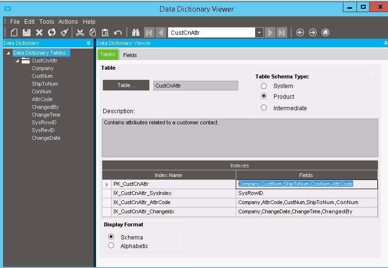

Looks like you are trying to create a duplicate attribute
Yeah, thats what I was thinking, but I can’t seem to find the duplicate. This would be a duplicate contact, right?
the key is Company,CustNum,ShipToNum,ConNum,AttrCode
So it is trying to duplicate that combination
