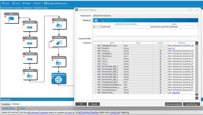

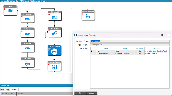

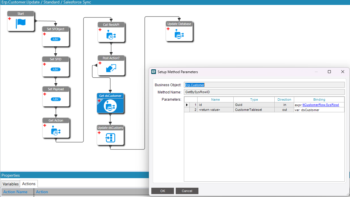

I’m building a standard data directive on Customer. The area where I’m having a problem is when I want to update a field in Customer. My first step in the update process is to get the Customer tableset into variable dsCustomer.

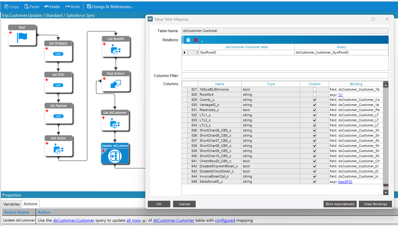

I then update the dsCustomer.Customer table by query. All fields are bound automatically in the mapping with the exception of RowMod and SalesforceID_c. I set the value of RowMod to “U” so it will update and set a value for SalesforceID_c. I don’t touch anything else in the tableset.D

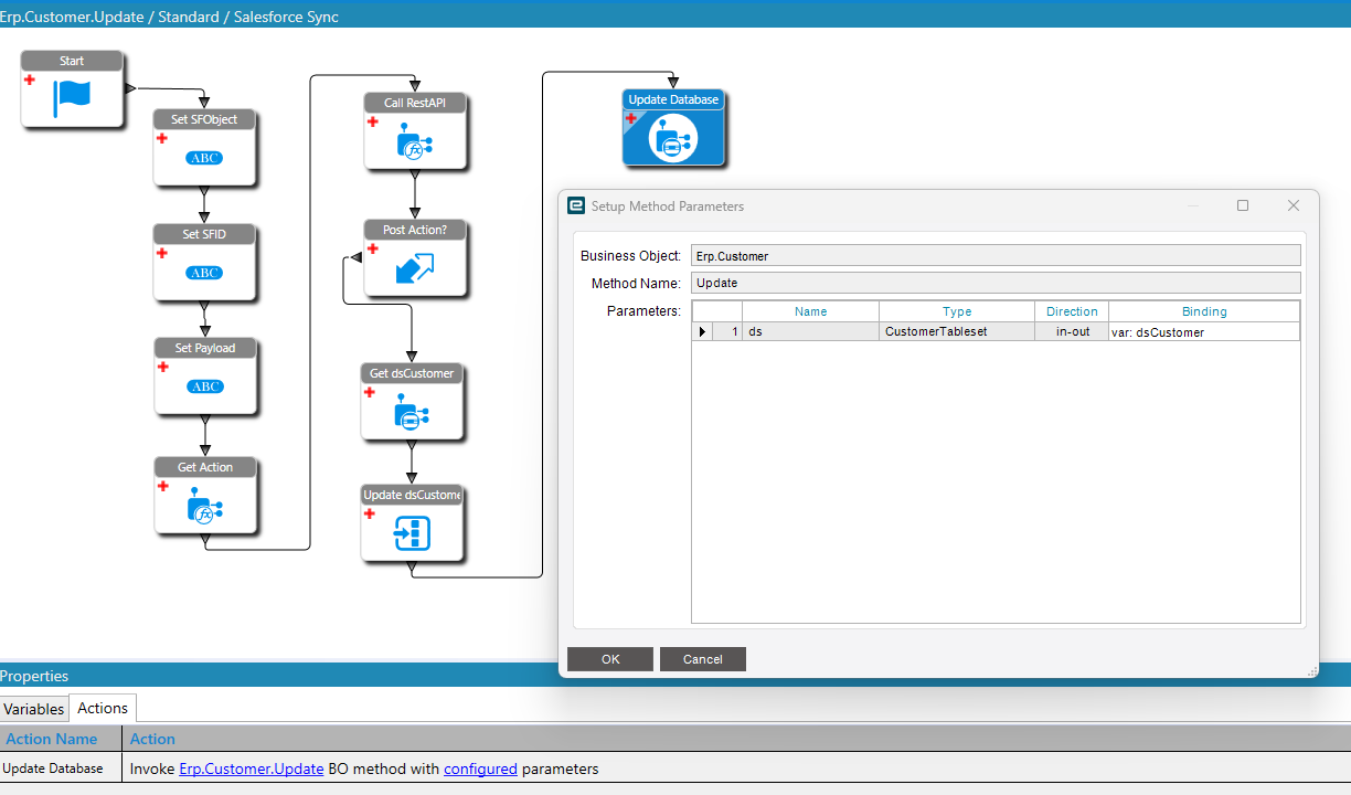

My final step is to call Erp.Customer.Update BO method binding the dsCustomer tableset. In my mind the tableset is exactly what I just retrieved except for the 2 changes in dsCustomer.Customer.
To my surprise the BO choked on the dataset with this error.

I suspect that the way you identified your customer record to update might be the problem. Can you use GetByID, instead of GetBySysRowID? I almost always use GetByID unless I have a good reason to use the GUID.

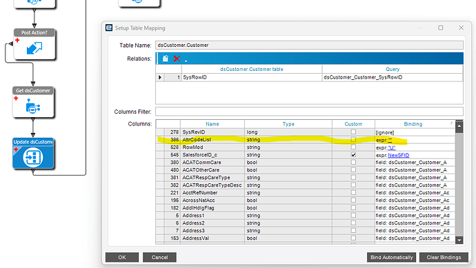

Thanks for the suggestion. I changed the BO, but still got the same result. After some trial and error, I found a solution. The customer tableset doesn’t directly include CustAttr. Instead the entries in the table are in Customer.AttrCodeList. Apparently the Update method thinks that anything that is in this field should be added to erp.CustAttr. So, my solution is to set that field to “” when I update dsCustomer.
Fortunately, the BO doesn’t appear to think that is should remove entries in erpCustAttr when if the AttrCodeList is empty. :slight_smile: Now the data directive works as expected.
