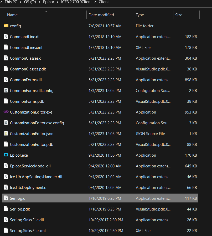

Appologies, I was mistaken. I got the compiled files into client folder like this:
I did unblocked the files and another crash happened. Here is the log:

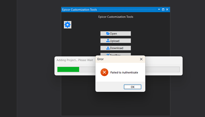

I managed to fix the previous issue. Then I tried to log into Epicor and got ā€˜Failed To Authenticate’. Any way to fix this ?
How are you authenticating? It only supports basic and SSO
I just enter username and password to log in to Epicor. Is that the basic way?
I got it fixed for now. Thank you for taking your time sir.
