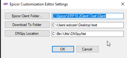

@josecgomez could you share the editor settings as an example?

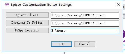

here is my settings but no work
%E5%9B%BE%E7%89%87
Download folder Is just an empty folder where you want the customizations downloaded to
The client path needs to point to the folder which contains the epicor dlls…
Did you download and install the helper libraries?

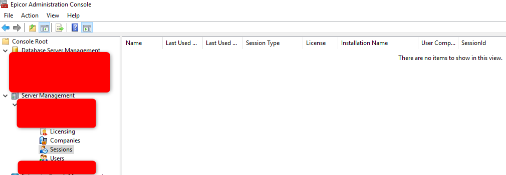

EDIT:
1- Providing false login info --> failed to authenticate.
2- Providing false login info for the second time, I’m stuck with this.
Gotta kill the process.

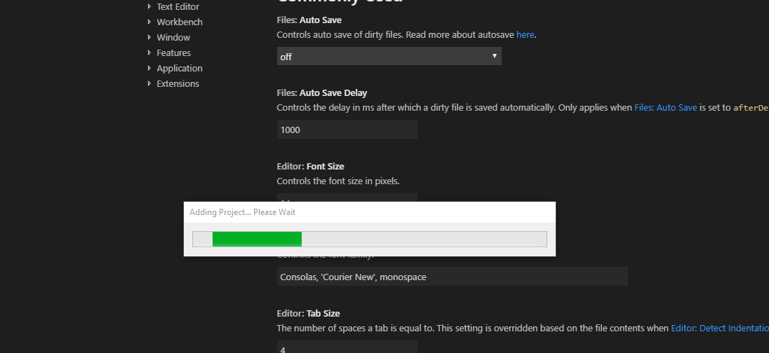

Before Login attemp in VS Code
After Login clicked in VS Code

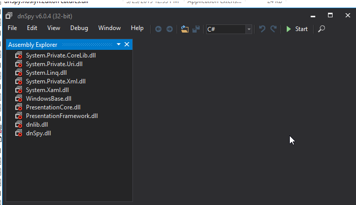

When clicking debug I get a message stating ā€œNo DNSpy Location was suppliedā€, but I have it entered in the settings. Any Ideas?
2019-05-08%2011_02_05-Epicor%20Customization%20Editor%20Settings
2019-05-08%2011_02_45-DNSpyNet
2019-05-08%2011_01_51-Add_POF_Test%20-%20Microsoft%20Visual%20Studio

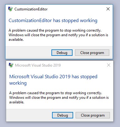

I am able to search for customizations and select one. The ā€œDownloading from Databaseā€ message pops up and then VS crashes. I have tried selecting different customizations and they all caused VS to crash.
Any idea’s on what I’m missing to make this work?
VS_Settings VS_Error
