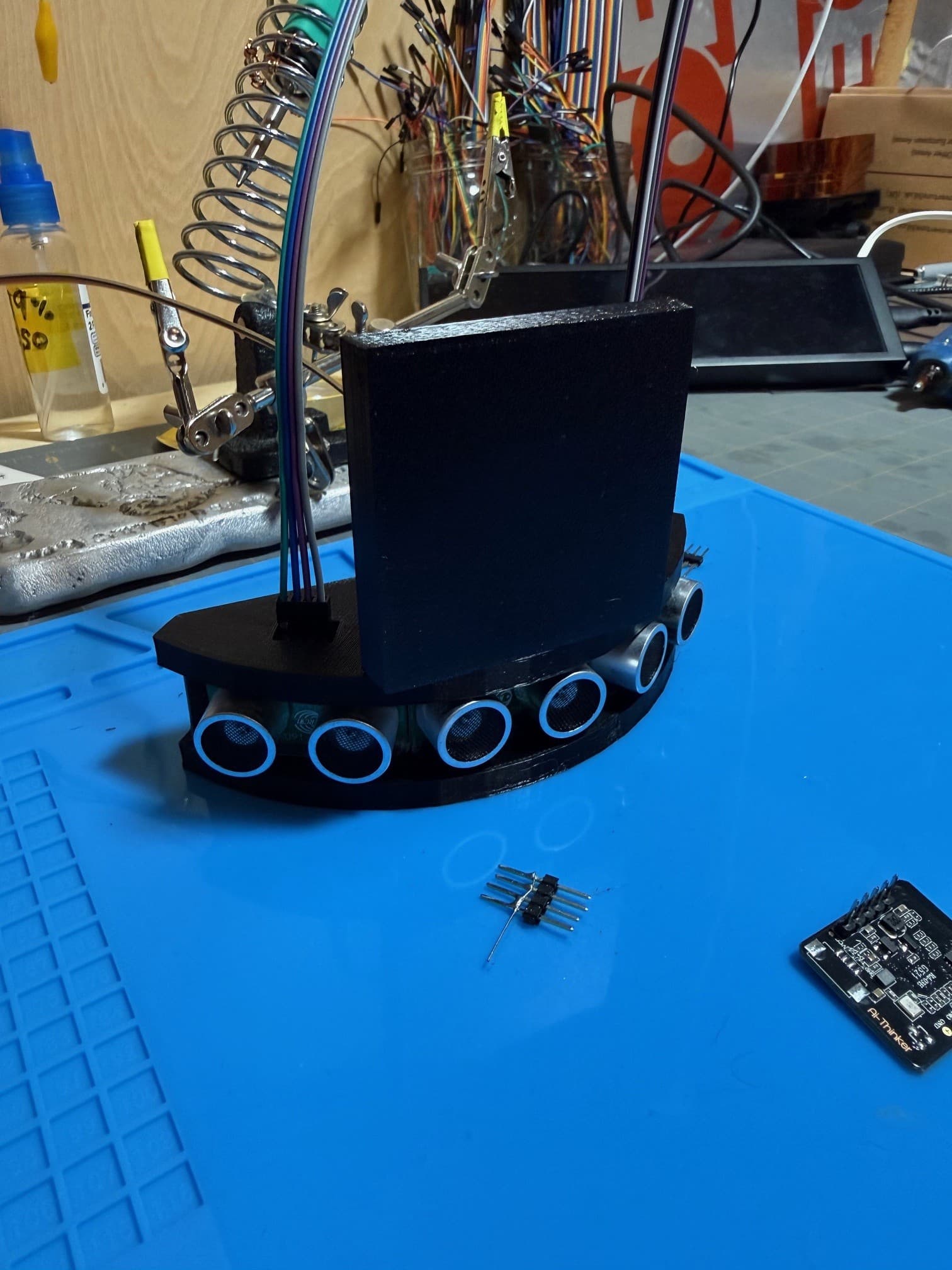

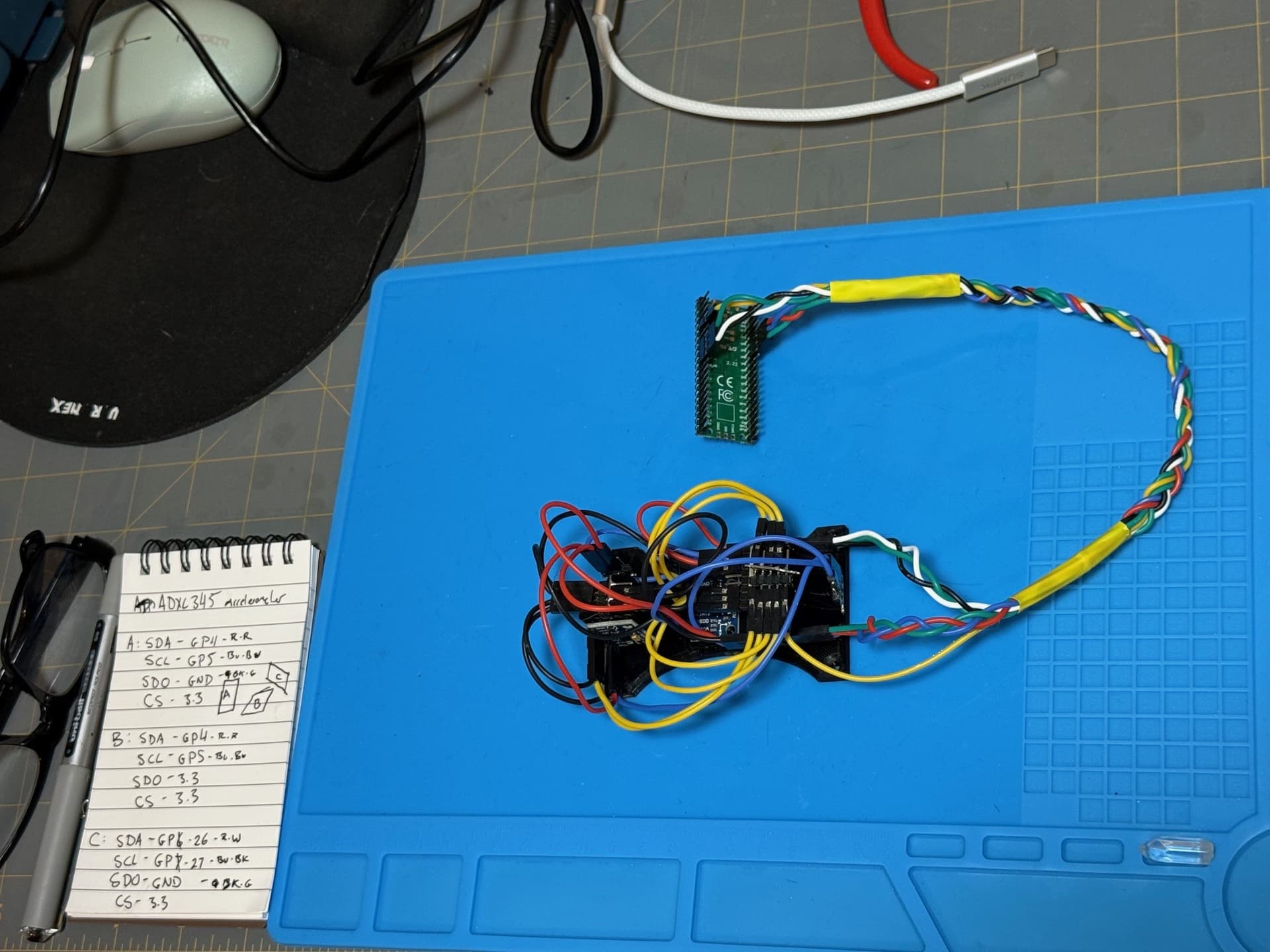

This is a project that combines virtually every sensor I could get my hands on, into a single detector. The sensors include:
  • 60GHz MMwave Presence detector
  • 3 x Ultrasonic distance sensors
  • 3 x MEMS accelerometers
  • PIR motion detector
  • Flame IR sensor
  • MEMS barometric pressure sensor
  • DHT11 Temp/Humid sensor
  • a variety of other types of temperature sensors
  • a variety of Hall magnetic sensors
  • a suite 9 of MQ gas sensors (MQ2-9, MQ135)
  • a 2.5um particle detector
  • a custom orthogonal capacitive environment sensor
  • Omnidirectional microphone
These sensors are all gathered with a few raspberry pi picos. That data is streamed out over USB via serial. All the picos are piped into a raspberry pi 4, that handles the visualizations and output.

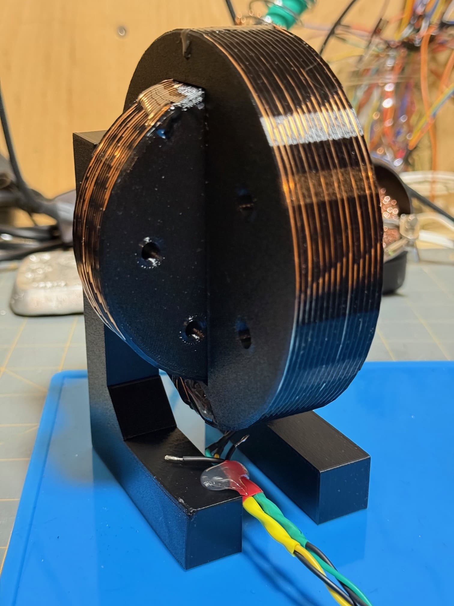

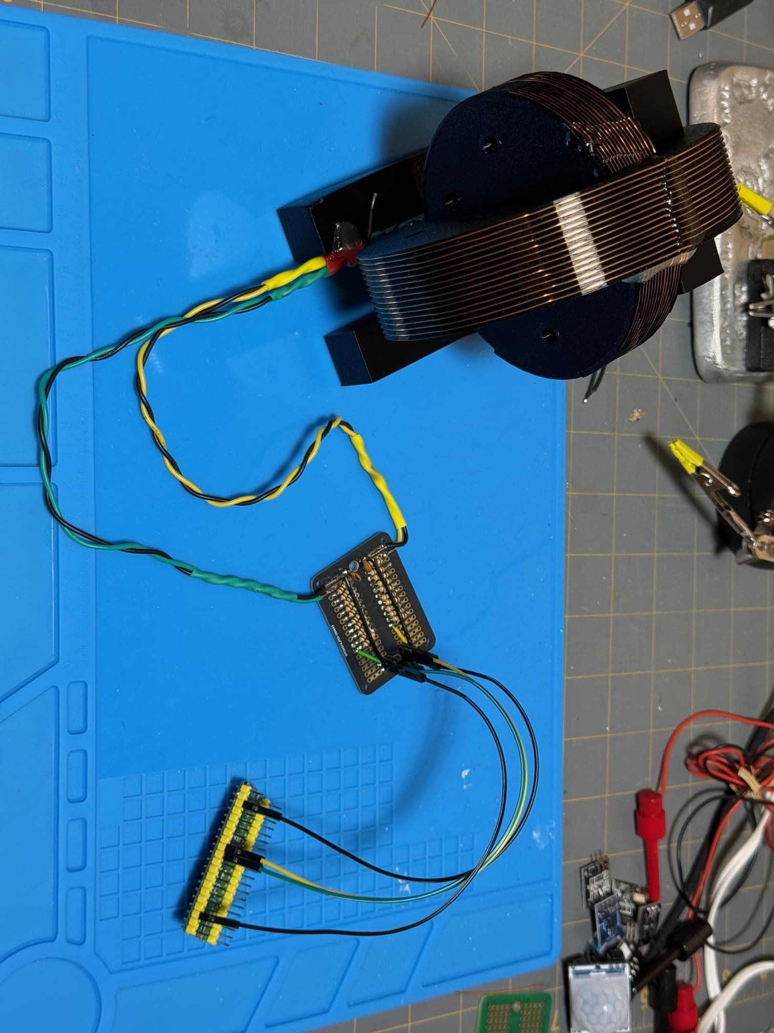

Our thinking is that if a ghost exists, and it has any ability at all to interact with the environment, then this gives the ghost the ability to interact with a device that can translate interactions into readings. MEMS devices in particular are sensitive to very small movements. The custom capacitive sensor is extremely sensitive and can detect me bobbing my head over 2 meters away! If the spirits have any intention to communicate, this would be the way they could do it electronically. To use the device, follow a simple procedure of asking your spirit a question, then observing the readings for a response. We can get into correlation later.

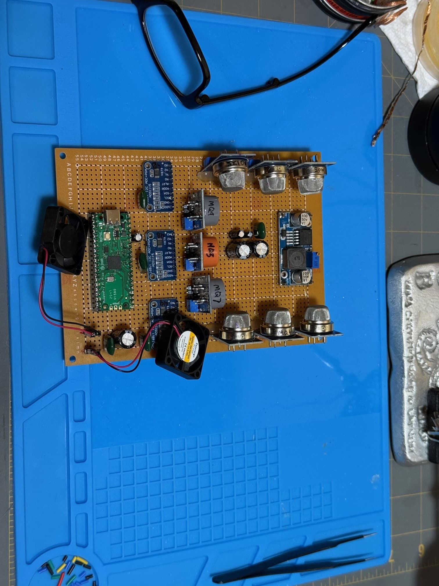

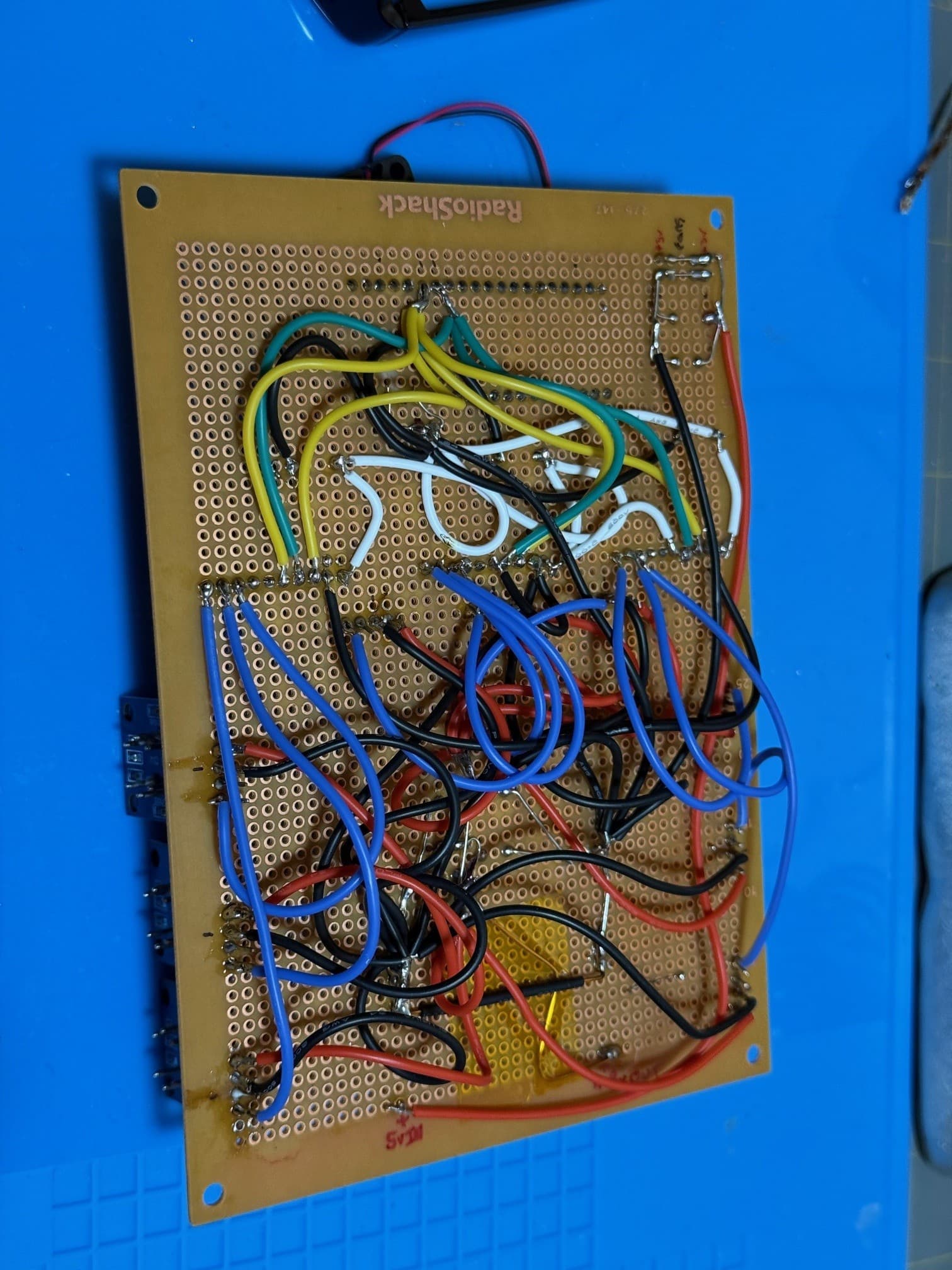

I am still deep in the process of designing and building it. I thought this would be the perfect project to get my own custom PCB manufactured. All the youtubers say its only $5 for 5 boards. I got my MQ gas sensors all laid up into a single PCB with multiplexing over I2C, dedicated power filtering, and a nice classy look. When I uploaded the files I was happy to see the cost was right around what I expected. As I moved through the process and got to the very end, they tacked on VAT and tariff charges that took my $5 order to over $50! That was enough to make me back off and do it myself the hard way.
Here’s a couple of shots showing off the mess I’ve gotten myself into.
MQ Gas Sensor Array
Orthogonal Capacitive Sensor
Triple 3-axis accelerometers
MMwave and ultrasonic sensors
I still have more sensors to add. I still need to design and build a case to hold it all. I still need to design the interface.

Yes, with clever ground plane placements I can sort of shield the sensing region.
That’s a bit different, but yes. I can tune everything about it. The hard part is deciding how sensitive to make every sensor. Separating the noise floor from real data, and showing it in a meaningful way. We are starting to get into statistics.
