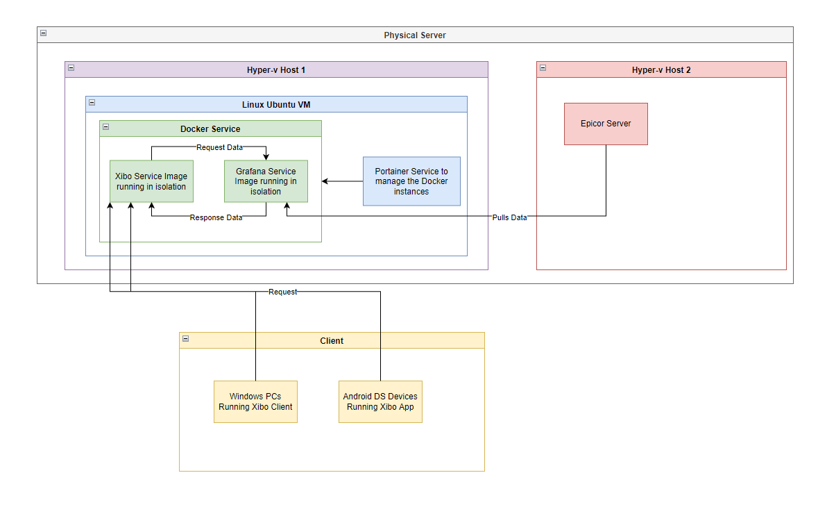

I am trying to get at the underlying hardware. Is your VM hosted on your network server? Do you use a standalone PC on each monitor?
Does this help?
The main goal of running Docker is say Grafana has a zero day. It’s running in Isolation from that docker container you can’t get anywhere else upwards from there.
Thank you! This really helps tie things together for me!
In our case yes @jgiese.wci this chart is accurate but that is because we use a “blade” type server. Most people their “Physicaly” plug it into the wall level Server is Hyper-V Host 1 and Hyper-V Host 2. Just to clarify that chart.
I’m afraid that didn’t clarify anything for me. But I bet someone with more networking knowledge might get it!
