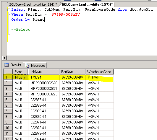

Ok so I was correct on my JobMtl pull I did but i don’t see any issues. The correct plants on the jobs match the correct warehouse code. I haven’t checked the PO Rel yet.
this is the warehouse that is wrong in Epicor.
I usually find the problem before any transaction, so I am able to change it on the job. Since there is a transaction already, I am not sure if you can remove the warehouse from the plant record.
That is what I was afraid of
