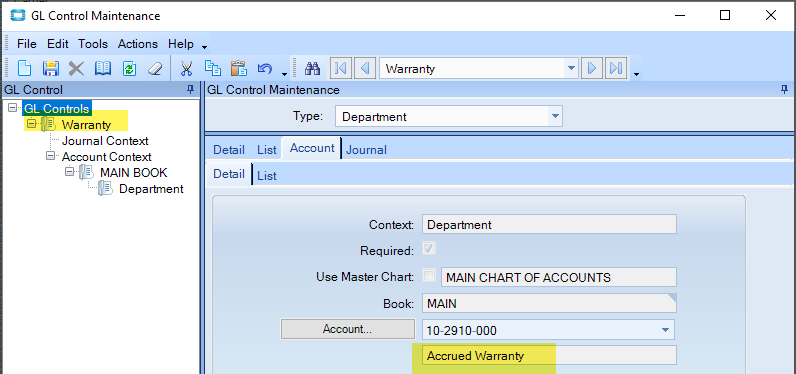

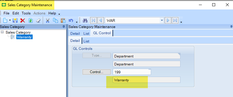

I am by no means an accountant, but I can tell you about how we manage our warranty to our accounting’s satisfaction. We do not use quick ship. We have a sales category called “warranty” with a g/l control tied to it. We do zero dollar sales order lines with jobs tied to them for our repair work. We dispose RMAs to the repair jobs, with the RMA part cost at disposition = $0. This ensures that we do not add cost of part to job, since it’s owned by customer already and we’re just fixing it. Then we add materials and do labor for operations and this goes into the cost of the job, tied make direct to the zero dollar sales order line. We do customer shipment and zero dollar invoice for warranty. We estimate the value of the shipment at the same cost as the original part, manually on our shipping documentation.

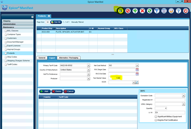

We use the Fair Market Value in the Products/Export tab in Manifest for that. Not sure if QuickShip is different. this allows you to enter a $1 value on the ship docs only, while keeping the Epicor side at $0.

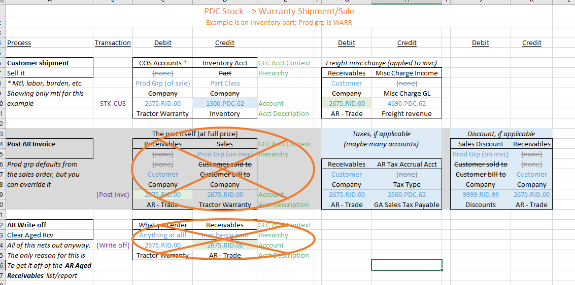

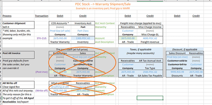

I mapped out the GL hierarchy of putting a value on the sales order itself. Obviously your account numbers will differ, etc. My X’s are to show that there was no advantage to the write-off process (for us); zero-dollar orders end up doing the same thing anyway.
