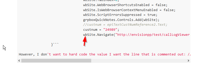

Okay, I have made progress. I have the webpage populating when I hard code the value.
		private void SetupBrowser()
				wbSite = new System.Windows.Forms.WebBrowser();
				wbSite.Dock = System.Windows.Forms.DockStyle.Fill;
				wbSite.Location = new System.Drawing.Point(0,0);
				wbSite.MinimumSize = new System.Drawing.Size(20,20);
				wbSite.Name = "wbSite";
				wbSite.Size = new System.Drawing.Size(560,323);
				wbSite.TabIndex=0;
				wbSite.WebBrowserShortcutsEnabled = false;
				wbSite.IsWebBrowserContextMenuEnabled = false;
				wbSite.ScriptErrorsSuppressed = true;
				grpboxQuickNotes.Controls.Add(wbSite);
				//custnum = epiTextCustNumReference2.Text;
				custnum = "24989";
				wbSite.Navigate("http://envisionpp/test/callLogViewer.asp?custnum=" + custnum.ToString());
However, I don't want to hard code the value I want the line that is commented out: //custnum = epiTextCustNumReference2.Text to feed the website browser with the customer number.
