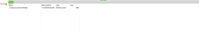

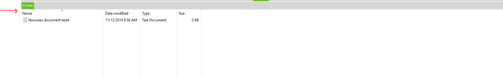

Thanks for this code, I used it successfully in my code with a variable URL. However, is it possible to add a toolbar to this so I can use the functions goBack or goForward or refresh?

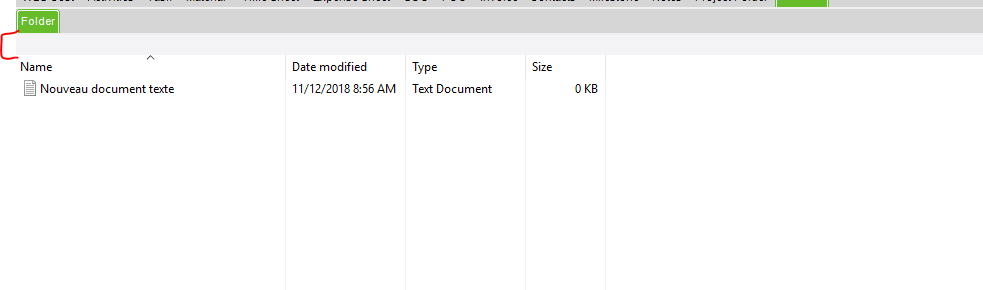

I’m not sure what I should change to include some buttons there:
EDIT:
I added this but not sure how to add a toolbar now:
browserDisplay.Dock = System.Windows.Forms.DockStyle.Bottom; // it was ‘Fill’ before
browserDisplay.Location = new System.Drawing.Point(0, 40);
Glad to see you’ve got the placement figured out. I’ve never needed to add a toolbar, but you should be able to put an EpiButton control in that space and trigger the browser’s GoBack() or GoForward() method on a click event.
Yep, I figured it out too, surprisingly easy! I added this code:
