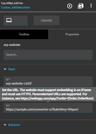

Has anyone successfully injected data into the URL of the website widget? The URL help specifically shows using the curly bracket syntax to reference views, but when the widget actually loads, it simply puts {View.Field} into the URL.

Out of curiosity, did you type your view.column correctly? I believe a typo might just print it out like yours is.
Also, if you are creating your view later on, you may have to click reload on the widget,
because the view does not exist when the widget tries to load.
In this case, the full placeholder Iâm using is {ReportParam.Jobs} on the Job Traveler print app. The autocomplete helpfully suggests it in this case.
Does the web widget reactively update the URL when placeholder values change? I also tried using property-set on the âurlâ property of the widget, but this doesnât seem to work.
[edit]This was in Chrome. Just tested in Kinetic client with same result.

Also, clicking reload on the widget has no effect on the URL.
Go ahead and add a textbox field to that screen and bind it to ReportParam.Jobs
See if that updates as expected.

Well What the âŚ
Iâm not sure why itâs not working.
Just for giggles, try marking it as a key field on the widget.
