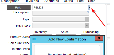

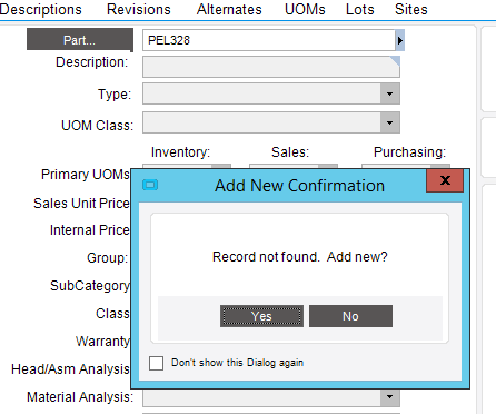

I’ve never stumbled upon this issue before…we have a part in the part table but Epicor cant find it.
Any idea why?

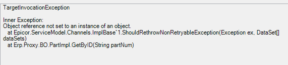

GetByID Method:
Space at the end or beginning? In the Db?
Does the Company matter? I notice the BO looks in the current company
Also as a general observation, I see that the GetByID, calls InnerGetByID, which actually uses a stored proc for the query
You are for sure looking at the same DB right? (had to ask)

Support is saying there could be a bad record in the plantwhse or partplant tables. We shall see.
Now what makes the bad record happen to begin with? Thats the million dollar question.
I am looking at the same DB hahaa. The weird thing is we dont have this issue in test , only in live. We refreshed test about a month ago.
Just curious … What is the little arrow next to the Part field?
Something new since 10.1.400? Or is this a customization?
@ckrusen BAQ Zone
You can make BAQ’s run when you hover over it. I have one for part where used. (and other things)

looks like it is because we have a bad warehouse / site combo in the plant whse table
How did that happen? hmmmm

I would have fixed this myself, but because I can’t even get the part dataset to update via get by ID in the bl tester I have to wait for a data fix from support.
One thing that we found is that we only got the Add New Error on a single app server. That made me think that it was a Client DLL mismatch.
You can try to load the Part Record from the client on the Epicor server and see if it lets you there. If it does you can just delete the bad PartPlant records.
