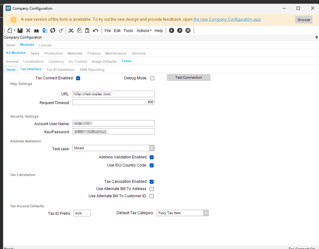

Company Configuration
Address accuracy is very important, specifically the state and I think zip code (apologies UK person trying to understand US state taxation).
You also need to set up tax codes, based upon Avalara codes and define a default tax code for products and then define any exceptions at the part level.

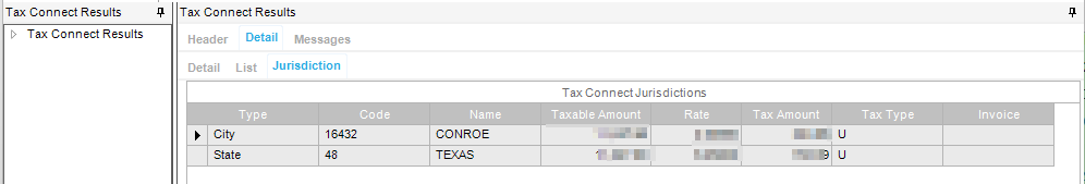

With these set up the taxes are generated at the point of order entry. One useful feature is the ability to see the tax breakdown generated by Avalara.
This is useful if you need to explain the tax amount to the customer.

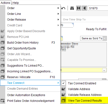

Tax Connect (Avalara) also includes address validation but it’s not automatic the user must go to Actions - Tax Connect - Validate Address as seen in second screen shot @aclements post above. That feature is available in Customer Entry, Order Entry, etc.

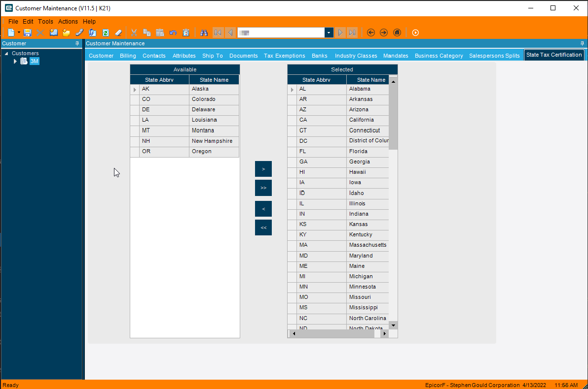

So, there are about 25-30 states that have this joint committee on tax exemptions or whatever, but the point is, they all use one form. With Avalara’s site, you can upload that form and say “this applies to the following states for us.”
But otherwise, yeah I think you are typing A LOT by hand.
