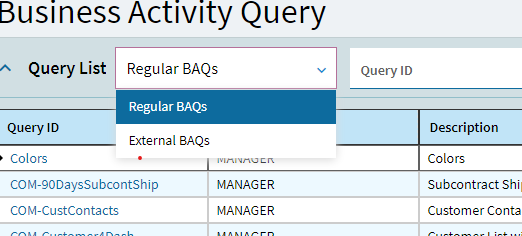

Olga:
In new UI
Don’t see it, maybe it’s something new and I need to purchase?
Olga
(Olga Klimova)
September 26, 2023, 6:09pm
14
Do you see this:
You need to be member of the External BAQ Designer group.
