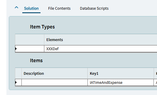

When you load your cab file into solution workbench, it should show the items in the customization

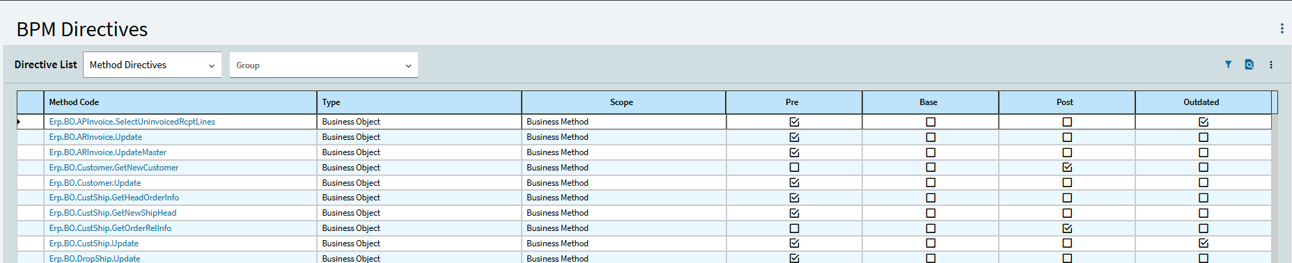

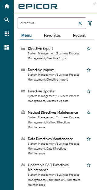

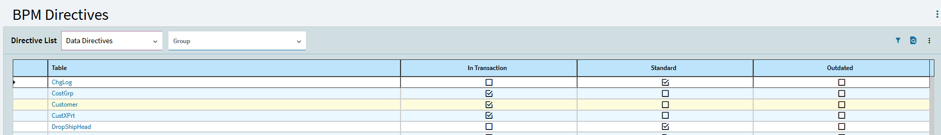

If you go into Method Directive Maintenance (Kinetic Version):
You’ll get a dashboard that shows Method (and Data) Directives. This shows you the directives you have on the system and their status.
Changing the dropdown to Data Directives will show those. This screen shows where they are attached to, either business objects or data tables. It also tells you if they run before (pre), instead of (base), or after (post) transactions for methods, and standard or In-transaction for data directives.
If you have a question about one of those, click on it and explore the widgets and/or code. Still have questions, you can post something here or engage with a consultant to explain it for you.

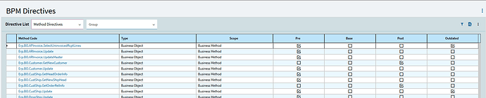

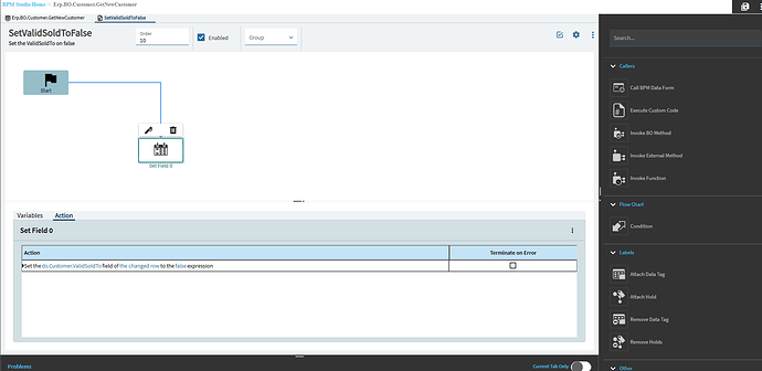

Thanks Mark. Here’s an example. This BPM is called “CustomerGetNewCustomer”. That doesn’t mean much to me and I didn’t get much help from customer service. But, I went to Method Directives and took a screenshot.
Side note: on my screen, it does not show a dropdown menu to change from Method Directives to Data Directives. Not sure if that matters, but I figured I should say.
Pre or Post directive? Should be post because you want Kinetic to create the record and THEN assign it the value. If you assign it will a pre-directive, it will get overwritten.
Did you do a trace of creating a new record and setting the ValidSoldTo field? There may be other methods that may also change it that you might not know about.
Correct. It is “post”.
