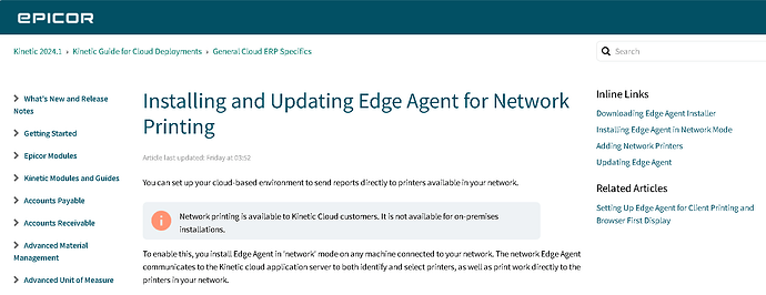

I haven’t tried this but I’m ready and willing to try anything out. Where would you find this Epicor Edge Agent? I’m not seeing it in my downloads on Epicweb but I could be looking in the wrong location.
Is this what you are referring to?
https://erphelp113100.zendesk.com/hc/en-us/articles/24036925670797-Installing-and-Updating-Edge-Agent-for-Network-Printing
Search your help for “Install Edge Agent”.
