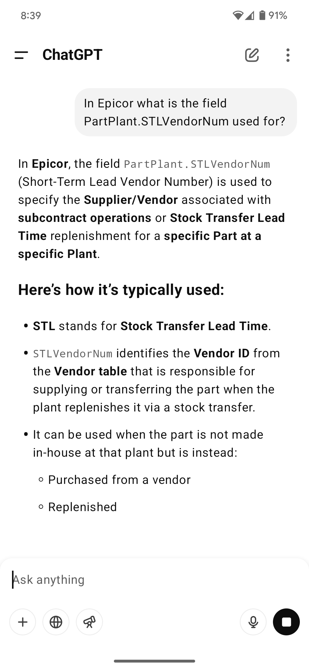

Lol, just wanted to see if this would work. Sounds legit, but I honestly have no idea.
I second your legitamousness
Except I think there was a transposition… STL vs SLT

So… not sure it has anything to do with stock transfers.
