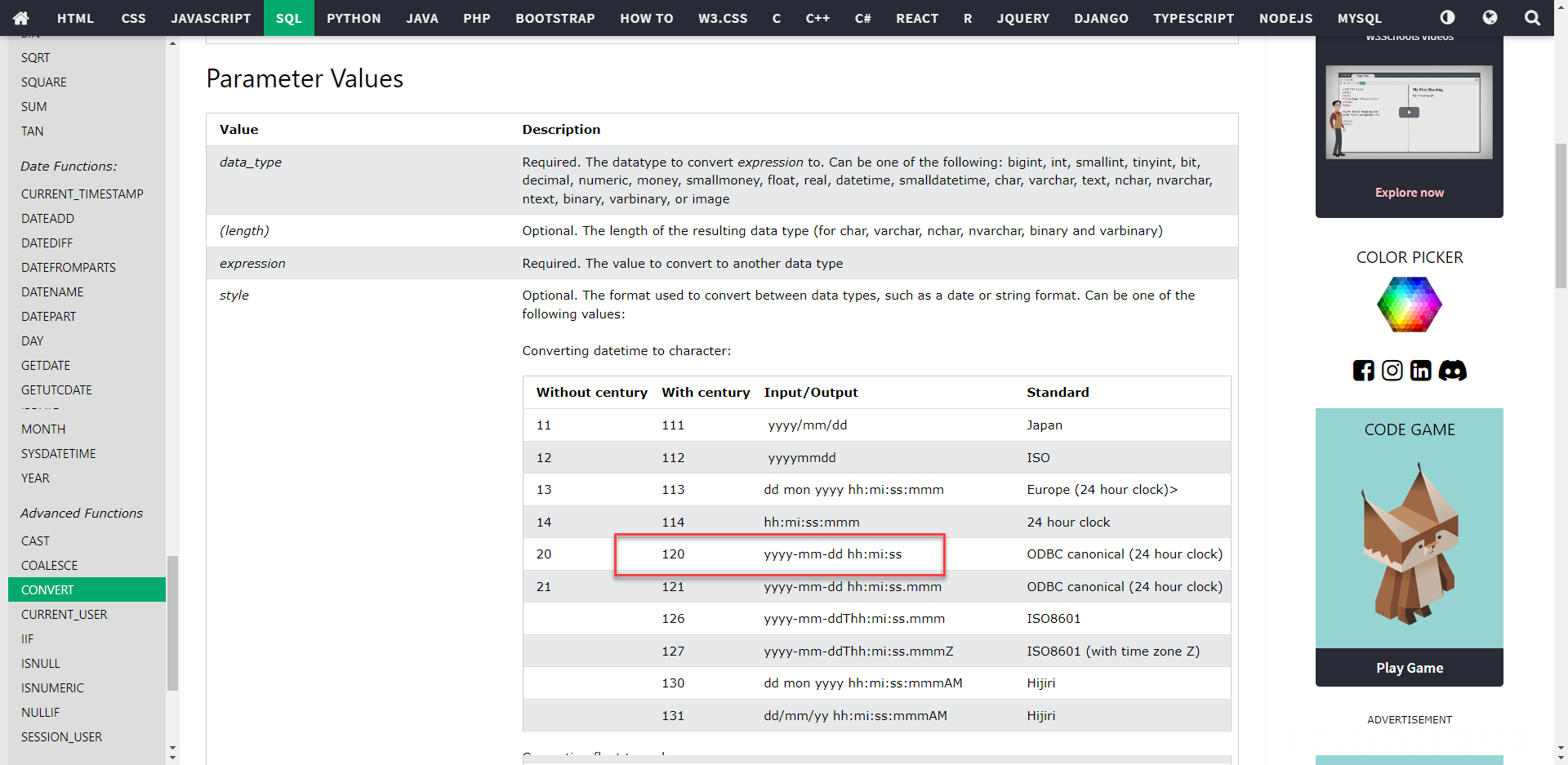

Looks to be a date format.
SQL Server CONVERT() Function (w3schools.com)

Looks to be converting a date value to a 7 character text field using the style # 120 which doesn’t seem like it would work but SQL might truncate accordingly. Most folks use this to strip off the “time” element of a datetime field.
I think it works more simply if you just cast(@End_date as date) instead of the Convert() syntax, but everyone has their own way.
Style 20 or 120 - ODBC canonical yyyy-mm-dd hh:mi:ss (24hr)
CAST and CONVERT (Transact-SQL) - SQL Server | Microsoft Learn

I agree - but I believe SQL will truncate, and if that’s the case, combined with the Style code, it would return ‘2022-11’ for today - meaning they were just going for the year/month, or period of the transaction.
