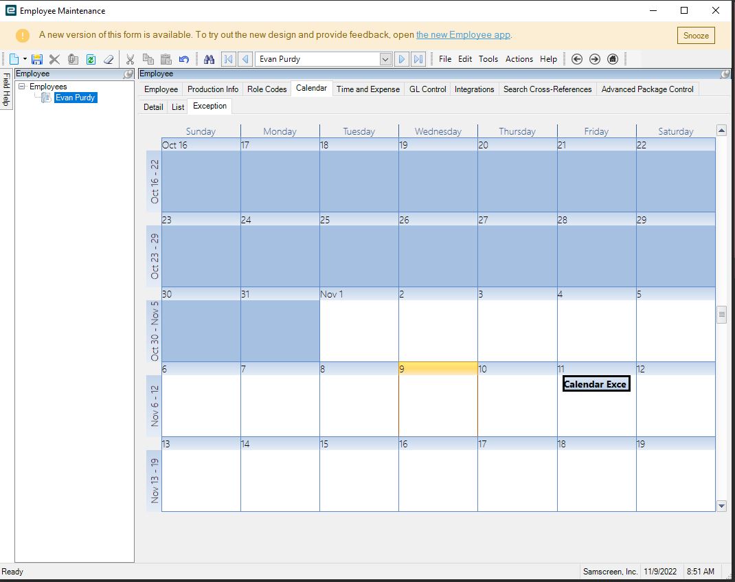

What table are Employee calendar exceptions stored?
I can’t seem to find the table these exceptions are stored in. Does anyone know ? My usual trick of using the field help doesn’t work in this case.

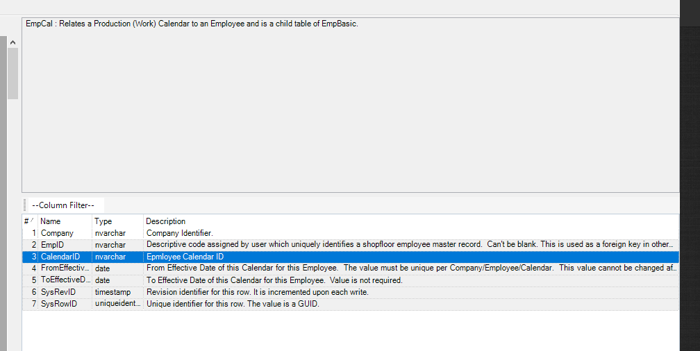

Erp.EmpCal I think is what you want.
That doesn’t store the exceptions though

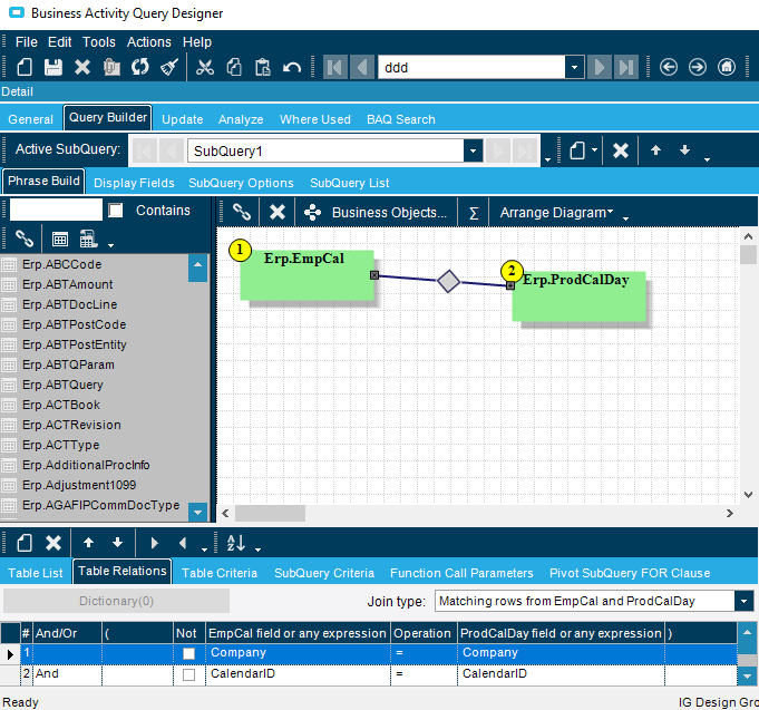

Ok, you’ll have to link a few tables, but the data is stored in Erp.ProdCalDay
Huh, I tried that but I must have got the joins wrong. What do your joins look like?

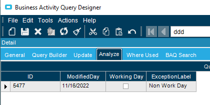

It’s actually on the ResourceCal table
Cheers
Connor
Huh, that gets me zero results, were as ResourceCal gets me the item.
Sorry, I didn’t look closely at your original picture. My way gets you the calendar exceptions. Doing the ResourceCal gets you the employee specific exceptions. Would you need both for a full picture?
Not sure. Right now I was just trying to answer the question “Is there anywhere we can enter employee vacation in Epicor?”
I really don’t like how its just a bunch of checkboxes and not a time range but it can probably still work for what we need.
