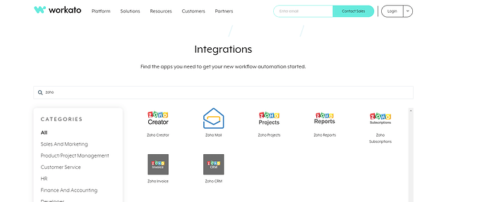

I think I am going to go with Zoho CRM… it’s a lot more refined since the last time I used it.
Does anyone know if Workauto will integrate Zoho CRM to Epicor?
I sent you the link to the integrations that workato has, did you see them there?
But don’t mistake the connector for the “recipe” Erik. There is still work to be done to get Epicor to integrate with Zoho.
@timshuwy can speak more on that. It doesn’t just “work” out of the box, you need to build some recipes.
@utaylor you are absolutely correct… seeing a connector does not mean that you buy the connection and you suddenly have an integration.
But what it DOES mean is that you can create a connection into Automation Studio from both Kinetic and Zoho, and then start making the recipes… some of those recipes may take you 15 minutes… some several hours… but you can have the integration built out and tested in a very short period of time.
