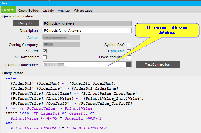

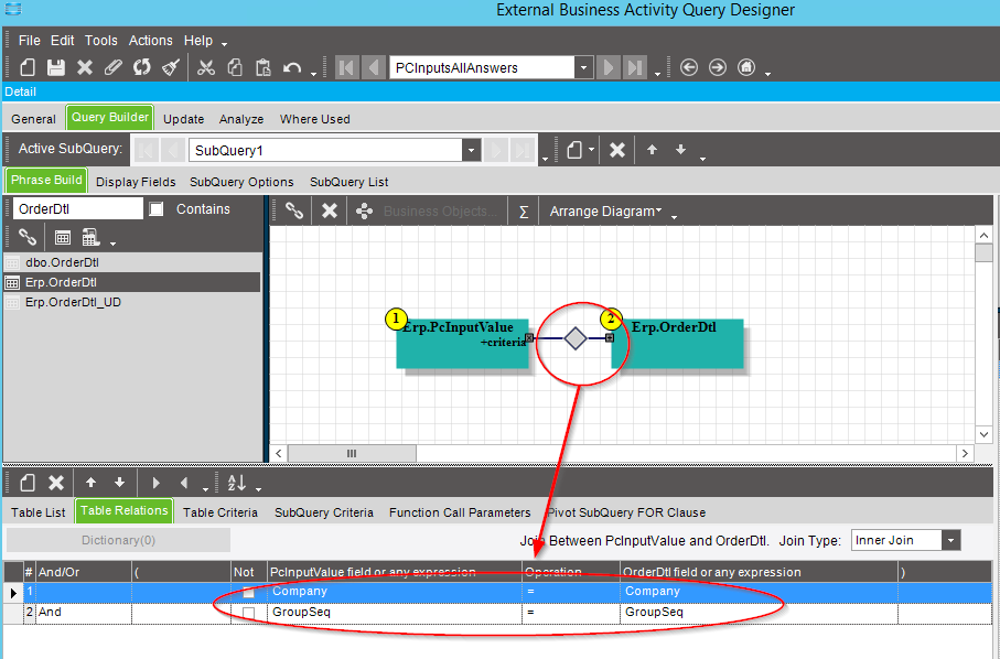

Not sure if multi-tenant can create External BAQs… but just in case… (And for those that CAN write them)… Yes, it is possible to write an external BAQ that directly extracts data from the PCInputValue table… you can then further summarize this and only extract the needed “InputValue” that you want to see. the link back to the Order Detail or Quote Detail or Job Header is always the GroupSeq column. Below are some screenshots.

I deleted my image, you can edit your post to remove the info as well. Though if you are really worried about it you should probably just change the password.
@timshuwy - That is a superb query idea - thank you for that nugget. Whipped it up and will use it well.
