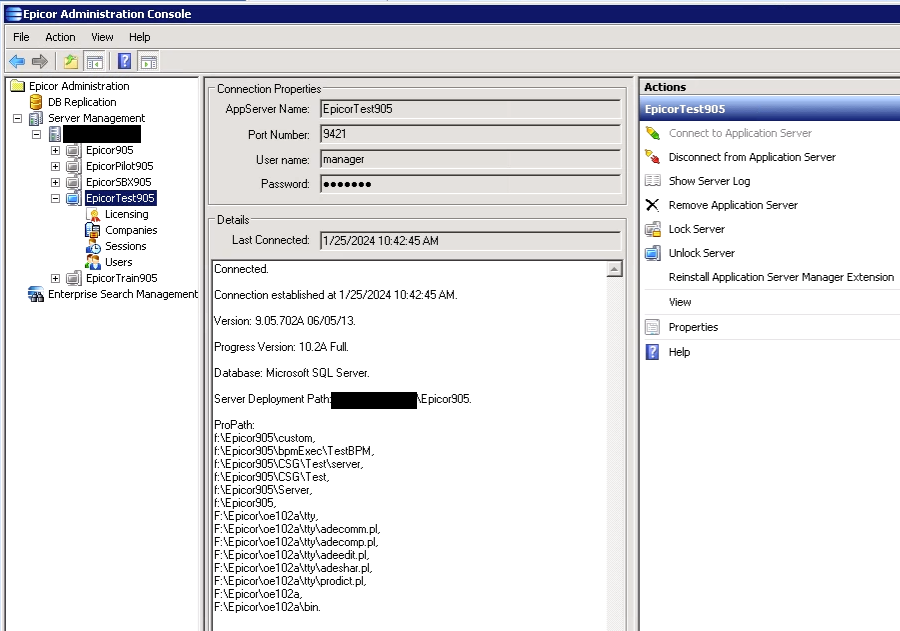

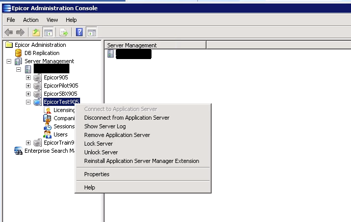

Something else to check, I seem to remember that V9 had two “admin” type programs. There was the Epicor Administration Console that you did the screen shots for. I believe there was also another admin program, don’t recall what the exact name, but I believe if you go to your Windows Start menu, it might have been under the Progress menu group. I believe Vantage 9 still ran with a Progress engine even if you were using SQL - it wasn’t until 10 that they removed Progress and sped things up quite a bit.
